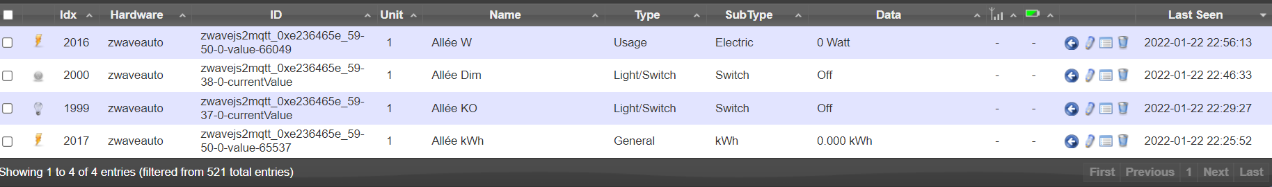

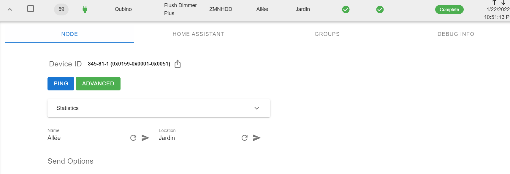

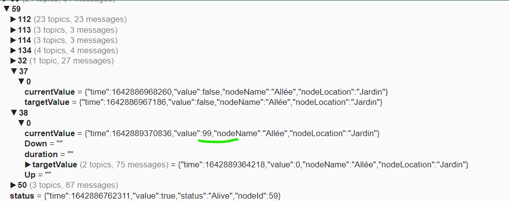

To add info on this point
An example on a node
Screenshot 2022-01-22 225503.png (43.84 KiB) Viewed 1057 times
Screenshot 2022-01-22 225649.png (71.72 KiB) Viewed 1057 times
Screenshot 2022-01-22 231135.png (46.98 KiB) Viewed 1057 times
last log:
2022-01-22 23:10:56.293 Status: dzVents: !Info: zTestOnOff: ==>> Device: Détecteur Salon : 2170 : Off / 0
For this device the trigger is not activated when the device is switch on.

Re: No trigger for device
Post by jvdz »
Status is looking good right? 99 = Off in ZWAVE.
Could you records the MQTT messages using the script available here and supply the output log, so we can "play them back" and see what is happening?
