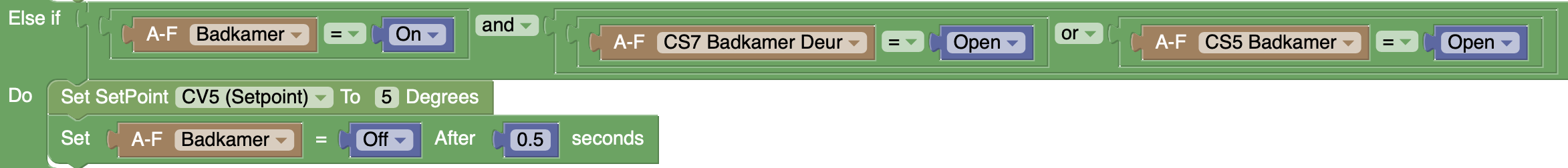

With Blockly you have everything you need for most House Automation, except calculation...
I think you are looking for this?

Im am told that "Nested Commands". can not be used?BennY wrote: Saturday 25 December 2021 21:36 With Blockly you have everything you need for most House Automation, except calculation...

Guess you mean Nested IF commands as the shown blockly doesn't have any nested commands and only a one level If- ELSEIF.
The AND OR logic could be a little bit tricky though.

Sorry for the late reply, but the suggestions displayed above is not what I mean/want.
I have a window and door switch in the bathroom. When they both are open, I want the radiator valve in the bathroom to be closed, even if the temperature sensor "says" heat the bathroom. Only when window and door are closed and temperature sensor is below the set value, I want the radiator valve to open, so the bathroom can be heated with a script.
In my script the bathroom is heated when both window and door are closed. But when the bathroom door is opened, the script is set to "close valve" , even when you only walk in and out within 10-20 sec. I would like a delay in the door sensor, that leaves the script "running" when the door is opened for less the 10-20 sec (so the valve/script won't close). When the door is opened longer then I assume the door is "normal" open and should the valve close/script end

That is what the blockly do, i Made for you on 25.12. You need a Dummy Switch for your delayed door. Then you use the Dummy instead your door Switch.njlammerts wrote: Saturday 05 February 2022 11:47 In my script the bathroom is heated when both window and door are closed. But when the bathroom door is opened, the script is set to "close valve" , even when you only walk in and out within 10-20 sec. I would like a delay in the door sensor, that leaves the script "running" when the door is opened for less the 10-20 sec (so the valve/script won't close). When the door is opened longer then I assume the door is "normal" open and should the valve close/script end
Benny
