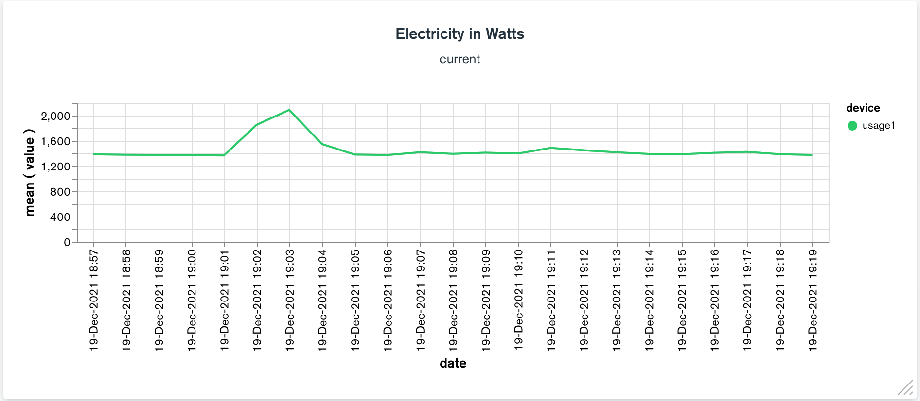

In my attempt to build a long term dataset, I am experimenting with cloud databases.
So on a rainy December Sunday I have created a sample integration for pushing data to MongoDB Cloud database (Atlas) with a Free account.
The full description is in the attachment. I am happy to put the steps on the wiki, but no clue on howto get an account. Any body a poiner?
Eugene
End result of cloud dashboard
MongoDB Charts Electricity in Watts.png (152.22 KiB) Viewed 839 times
