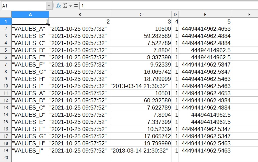

Since you can only get the raw data in txt and it's not a uniform delimiter (quotes as well as tab here), you are going to have to parse through it. I found a script online so will this work?
Screenshot 2021-12-19 131500.jpg (234.1 KiB) Viewed 11126 times

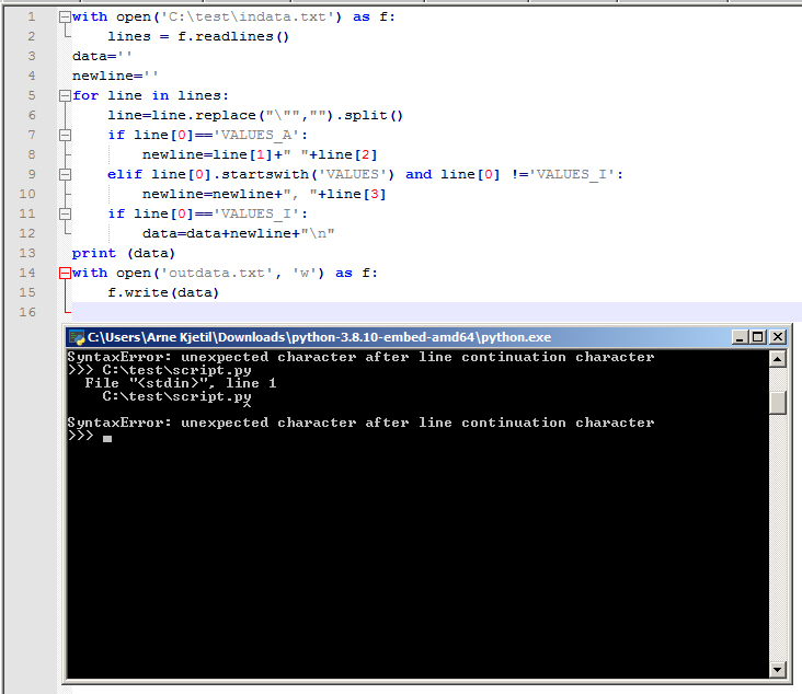

siklosi wrote: Sunday 19 December 2021 19:20 Here is python3 script that should do the job.
save as script.py, put data in indata.txt and run with python3 script.py... you will get outdata.txt with formatted text
Not familiare with phyton, but gave it a try :-)

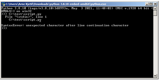

siklosi wrote: Monday 20 December 2021 7:46 why don't you try putting script in same folder C:/test and using it without path... open('indata.txt') as f:
backslash is escape character so when you need real backslash you have to use double like c:\\test\\indata.txt
Everything are in the same folder...
And for some reason it works, and in the next moment it doesn't work...
Got this error "SyntaxError: unexpected character after line continuation character"
Tested on 2 different machines, one Win7 and one Win10 ..

Post by user4563 »
Run the script in CMD or PowerShell like this:
python.exe "C:\test\script.py"
If you want to run in the Python shell window:
exec(open('C:/test/script.py').read())

user4563 wrote: Tuesday 21 December 2021 1:45 Run the script in CMD or PowerShell like this:
Still the same, somtimes it works, somtime it doesn't ...
But when it works, it's almost good :-), just missing the most important parameter .. the first ...
