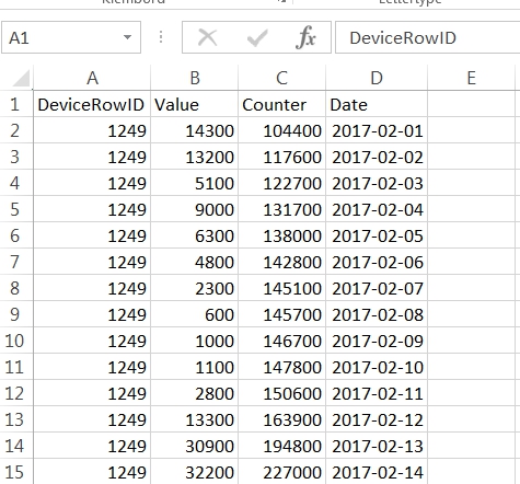

1 First put all data in a csv file in the correct format. comma separated etc.

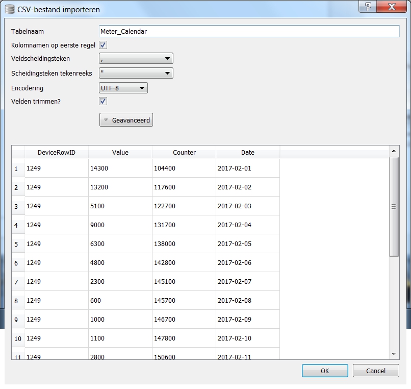

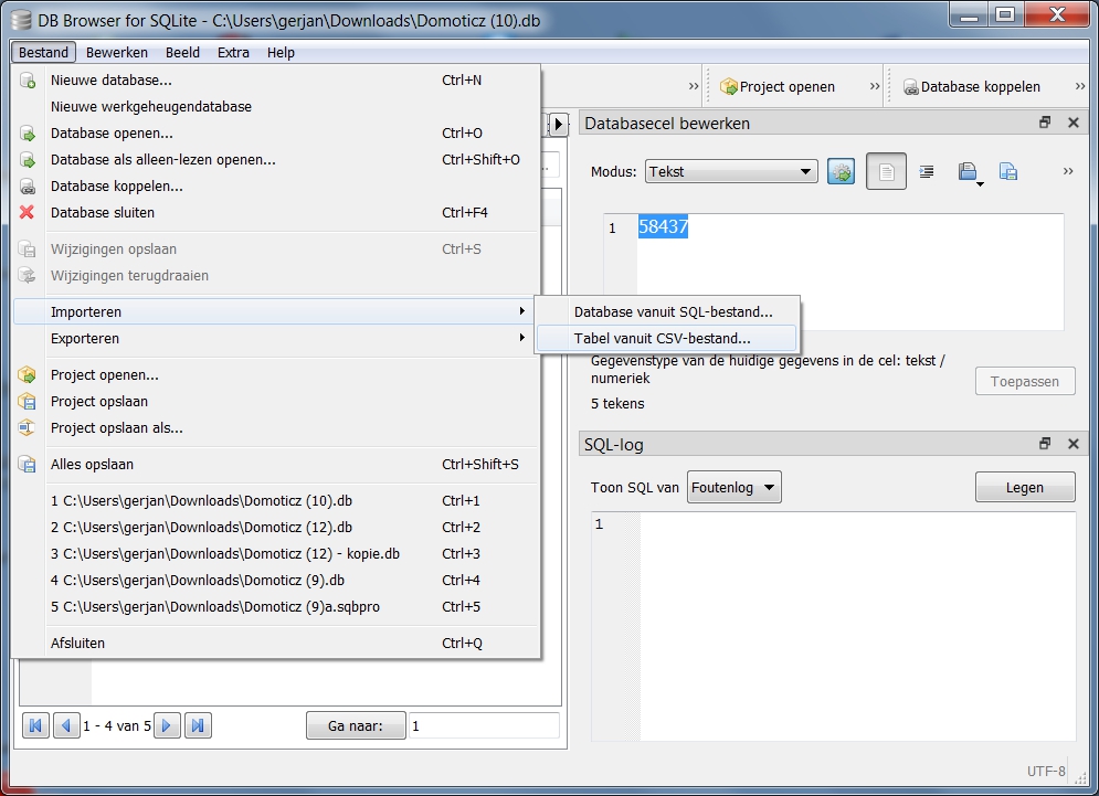

3 Copy the backup, and open copy with DB Browser (SQLite).
4 Now you can import the CVS, indicate correct folder, with me 'Meter_Calendar' You will be asked if you want to add the values.
5 Save and close the DB

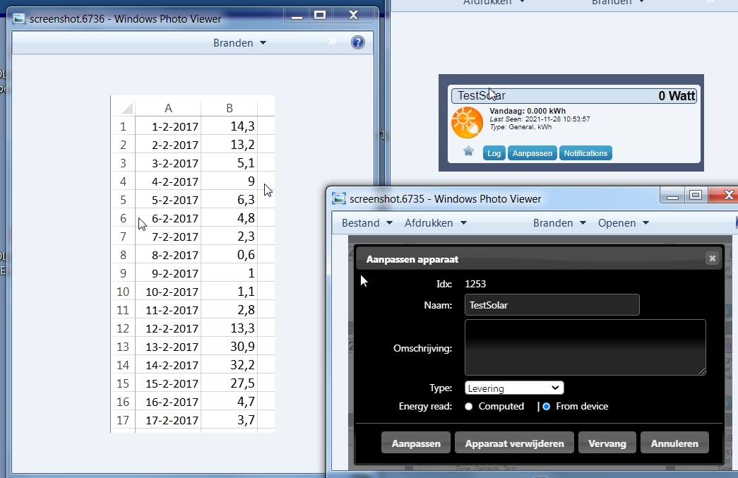

Make a good CSV file
Here some screenschots
Open db and insert.
CSV insert, see tabel looking good.
