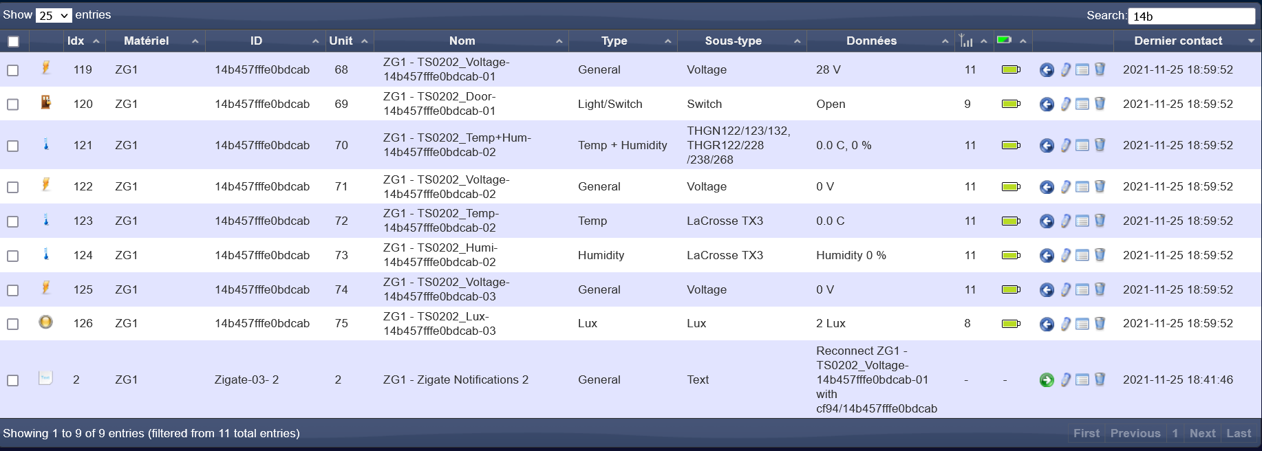

dondipietro
- Posts: 19
- Joined: Thursday 28 March 2019 11:11
- Domoticz version: 2021.1
Re: Zigate with Tuya 4 in 1 Sensor : PIR - Temperature - Humidity- Light
Lux seems to work and react well when I put a light on it.
But temperature and humidity doesn't change when I take it in hands and reset it.
Temper seems to be linked to "TS0202_Voltage"
I don't see PIR / motion detector

After reset of the sensor and re-pairing :
Humidity and temperature ar set to 0 and doesn't change.
- Capture.PNG (134.13 KiB) Viewed 2027 times

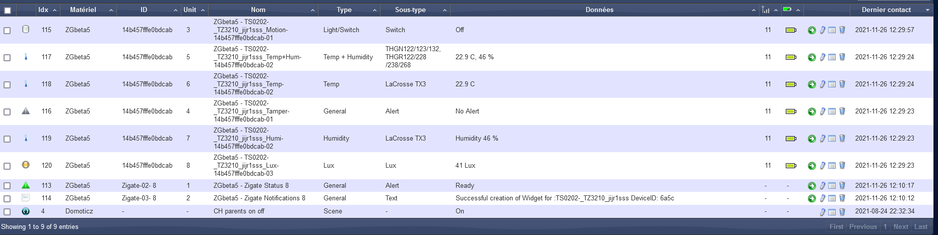

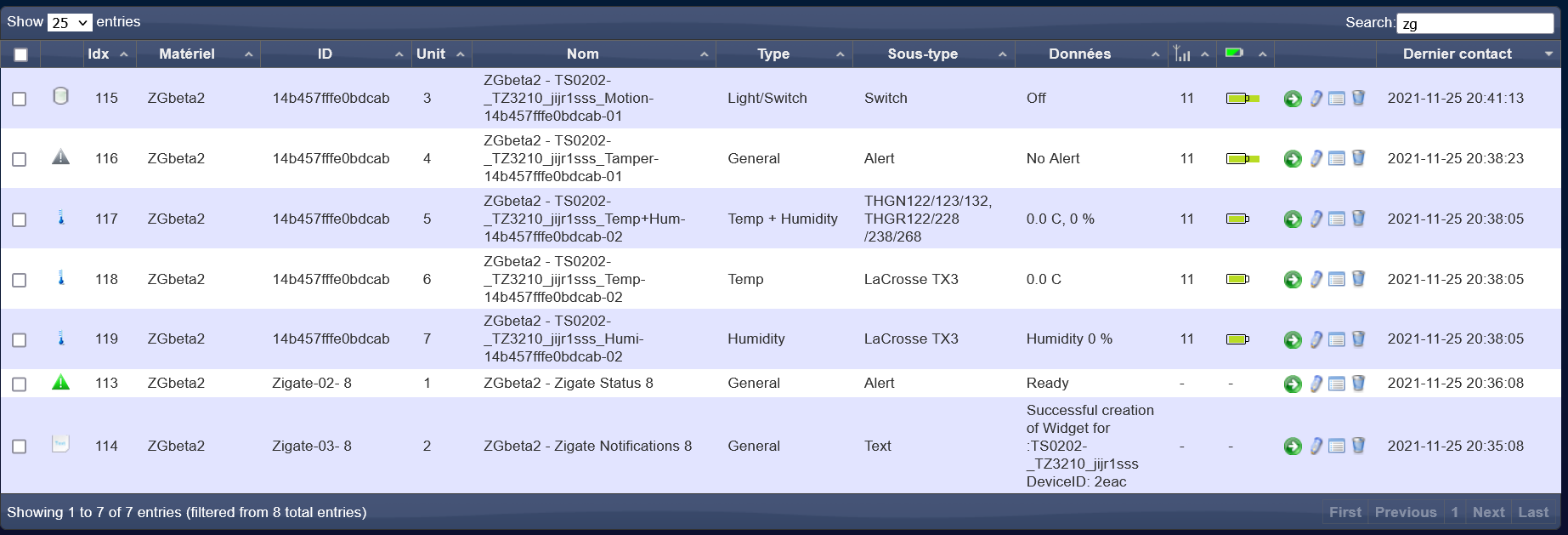

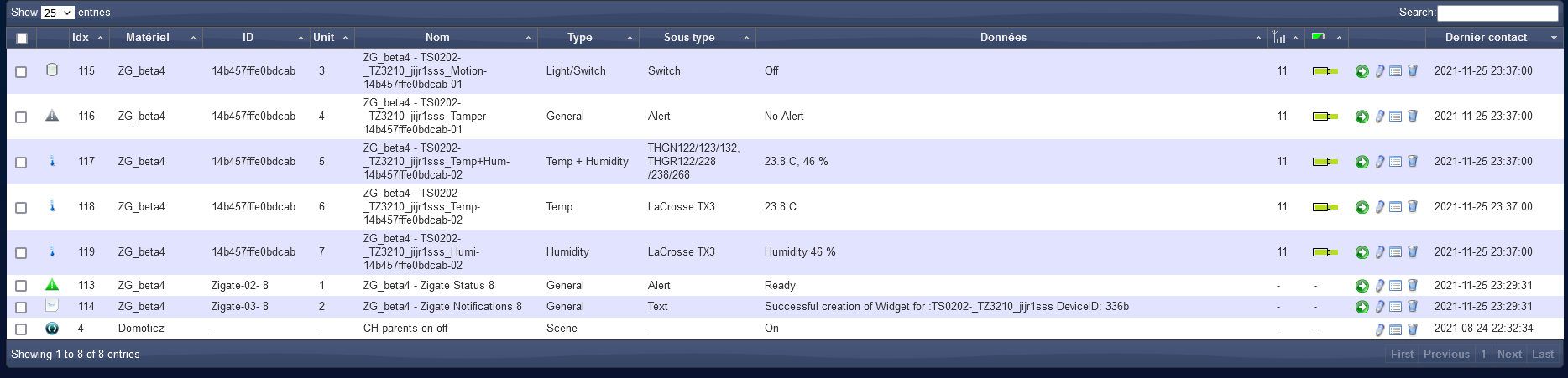

First, big thank you for your support !
With this update, Motion and tamper seems ok.
I loose LUX
and temperature humidity is not working.
Here is some error given by Zigate plugin when pairing and export object export.
Here is log output when unplug - plug the sensor :
I loose LUX

Hello Again,
A lot of progress !
I use zigate v1 with firmware ZiGate_v3.20-OPDM.bin
Here is the result with the last test :
MOTION Sensor : OK
TAMPER : OK
TEMPERATURE : OK
HUMIDITY : OK
BATTERY Level : show 200% (I power it with usb not battery)
LUX sensor is missing, but it was OK with your first Beta version I tested, is it possible for you to make it work again ?
Output log : from pairing then with a restart of the sensor.

I think everything look OK with this version.
Here is the log file :

2021-11-26 12:10:00.864 Status: ZGbeta5: (ZGbeta5) [None] NEW OBJECT: 6a5c None
2021-11-26 12:10:01.844 Status: ZGbeta5: (ZGbeta5) [-] NEW OBJECT: 6a5c Active Endpoint Response Ep: 01 LQI: 201
2021-11-26 12:10:01.845 Status: ZGbeta5: (ZGbeta5) [-] NEW OBJECT: 6a5c Active Endpoint Response Ep: 02 LQI: 201
2021-11-26 12:10:01.845 Status: ZGbeta5: (ZGbeta5) [-] NEW OBJECT: 6a5c Active Endpoint Response Ep: 03 LQI: 201
2021-11-26 12:10:01.845 Status: ZGbeta5: (ZGbeta5) [-] NEW OBJECT: 6a5c Request Simple Descriptor for Ep: 01
2021-11-26 12:10:01.846 Status: ZGbeta5: (ZGbeta5) [-] NEW OBJECT: 6a5c Request Simple Descriptor for Ep: 02
2021-11-26 12:10:01.846 Status: ZGbeta5: (ZGbeta5) [-] NEW OBJECT: 6a5c Request Simple Descriptor for Ep: 03
2021-11-26 12:10:02.874 Status: ZGbeta5: (ZGbeta5) [-] NEW OBJECT: 6a5c Simple Descriptor Response EP: 0x01 LQI: 201
2021-11-26 12:10:02.875 Status: ZGbeta5: (ZGbeta5) [-] NEW OBJECT: 6a5c ProfileID 0104
2021-11-26 12:10:02.875 Status: ZGbeta5: (ZGbeta5) [-] NEW OBJECT: 6a5c ZDeviceID 0402
2021-11-26 12:10:02.875 Status: ZGbeta5: (ZGbeta5) [-] NEW OBJECT: 6a5c Application Version 0001
2021-11-26 12:10:02.876 Status: ZGbeta5: (ZGbeta5) [-] NEW OBJECT: 6a5c Cluster IN Count: 04
2021-11-26 12:10:02.876 Status: ZGbeta5: (ZGbeta5) [-] NEW OBJECT: 6a5c Cluster In 1: 0000 (Basic)
2021-11-26 12:10:02.876 Status: ZGbeta5: (ZGbeta5) [-] NEW OBJECT: 6a5c Cluster In 2: 0001 (Power Configuration)
2021-11-26 12:10:02.876 Status: ZGbeta5: (ZGbeta5) [-] NEW OBJECT: 6a5c Cluster In 3: 0500 (IAS Zone)
2021-11-26 12:10:02.877 Status: ZGbeta5: (ZGbeta5) [-] NEW OBJECT: 6a5c Cluster In 4: ef00
2021-11-26 12:10:02.877 Status: ZGbeta5: (ZGbeta5) [-] NEW OBJECT: 6a5c Cluster OUT Count: 02
2021-11-26 12:10:02.877 Status: ZGbeta5: (ZGbeta5) [-] NEW OBJECT: 6a5c Cluster Out 1: 0019 (Over-the-Air Upgrade)
2021-11-26 12:10:02.878 Status: ZGbeta5: (ZGbeta5) [-] NEW OBJECT: 6a5c Cluster Out 2: 000a (Time)
2021-11-26 12:10:03.904 Status: ZGbeta5: (ZGbeta5) [-] NEW OBJECT: 6a5c Simple Descriptor Response EP: 0x02 LQI: 204
2021-11-26 12:10:03.905 Status: ZGbeta5: (ZGbeta5) [-] NEW OBJECT: 6a5c ProfileID 0104
2021-11-26 12:10:03.905 Status: ZGbeta5: (ZGbeta5) [-] NEW OBJECT: 6a5c ZDeviceID 0302
2021-11-26 12:10:03.905 Status: ZGbeta5: (ZGbeta5) [-] NEW OBJECT: 6a5c Application Version 0001
2021-11-26 12:10:03.906 Status: ZGbeta5: (ZGbeta5) [-] NEW OBJECT: 6a5c Cluster IN Count: 03
2021-11-26 12:10:03.906 Status: ZGbeta5: (ZGbeta5) [-] NEW OBJECT: 6a5c Cluster In 1: 0001 (Power Configuration)
2021-11-26 12:10:03.906 Status: ZGbeta5: (ZGbeta5) [-] NEW OBJECT: 6a5c Cluster In 2: 0402 (Temperature Measurement)
2021-11-26 12:10:03.907 Status: ZGbeta5: (ZGbeta5) [-] NEW OBJECT: 6a5c Cluster In 3: 0405 (Relative Humidity Measurement)
2021-11-26 12:10:03.907 Status: ZGbeta5: (ZGbeta5) [-] NEW OBJECT: 6a5c Cluster OUT Count: 00
2021-11-26 12:10:04.878 Status: ZGbeta5: (ZGbeta5) [-] NEW OBJECT: 6a5c Simple Descriptor Response EP: 0x03 LQI: 201
2021-11-26 12:10:04.878 Status: ZGbeta5: (ZGbeta5) [-] NEW OBJECT: 6a5c ProfileID 0104
2021-11-26 12:10:04.878 Status: ZGbeta5: (ZGbeta5) [-] NEW OBJECT: 6a5c ZDeviceID 0106
2021-11-26 12:10:04.879 Status: ZGbeta5: (ZGbeta5) [-] NEW OBJECT: 6a5c Application Version 0001
2021-11-26 12:10:04.879 Status: ZGbeta5: (ZGbeta5) [-] NEW OBJECT: 6a5c Cluster IN Count: 02
2021-11-26 12:10:04.879 Status: ZGbeta5: (ZGbeta5) [-] NEW OBJECT: 6a5c Cluster In 1: 0001 (Power Configuration)
2021-11-26 12:10:04.880 Status: ZGbeta5: (ZGbeta5) [-] NEW OBJECT: 6a5c Cluster In 2: 0400 (Illuminance Measurement)
2021-11-26 12:10:04.880 Status: ZGbeta5: (ZGbeta5) [-] NEW OBJECT: 6a5c Cluster OUT Count: 00
2021-11-26 12:10:07.129 Status: ZGbeta5: (ZGbeta5) [None] NEW OBJECT: 6a5c Request Node Descriptor
2021-11-26 12:10:12.090 Status: ZGbeta5: (ZGbeta5) [2] NEW OBJECT: 6a5c Model Name: TS0202-_TZ3210_jijr1sss
2021-11-26 12:10:12.091 Status: ZGbeta5: (ZGbeta5) [None] NEW OBJECT: 6a5c Request Node Descriptor
2021-11-26 12:10:12.188 Status: ZGbeta5: (ZGbeta5) [2] NEW OBJECT: 6a5c 0xCreateDB - IAS Zone controler setting
2021-11-26 12:12:08.852 ZGbeta5: (ZGbeta5) tuya_response - Model: TS0202-_TZ3210_jijr1sss Nwkid: 6a5c/01 dp: 6e dt: 02 data: 00000064
2021-11-26 12:12:08.853 ZGbeta5: (ZGbeta5) tuya_smart_motion_all_in_one - Model: TS0202-_TZ3210_jijr1sss Unknow Nwkid: 6a5c/01 dp: 6e data type: 2 data: 00000064
2021-11-26 12:12:10.034 ZGbeta5: (ZGbeta5) ReadCluster - 0400 - 6a5c/03 AttrId: 0000 AttrType: 21 Attsize: 0002 Status: 00 AttrValue: 6259
2021-11-26 12:12:10.035 ZGbeta5: (ZGbeta5) readCluster - 0400 - 6a5c/03 Attr: 0000 Type: 21 Size: 0002 6259
2021-11-26 12:12:10.035 ZGbeta5: (ZGbeta5) ReadCluster - 0400 - 6a5c/03 - LUX Sensor: 25177/329
2021-11-26 12:12:10.052 ZGbeta5: (ZGbeta5) UpdateDevice - (ZGbeta5 - TS0202-_TZ3210_jijr1sss_Lux-14b457fffe0bdcab-03) 329:329
2021-11-26 12:12:11.255 ZGbeta5: (ZGbeta5) tuya_response - Model: TS0202-_TZ3210_jijr1sss Nwkid: 6a5c/01 dp: 6b dt: 02 data: 000000e7
2021-11-26 12:12:11.256 ZGbeta5: (ZGbeta5) tuya_smart_motion_all_in_one - Temperature 231
2021-11-26 12:12:11.272 ZGbeta5: (ZGbeta5) UpdateDevice - (ZGbeta5 - TS0202-_TZ3210_jijr1sss_Temp+Hum-14b457fffe0bdcab-02) 0:23.1;0.0;2
2021-11-26 12:12:11.288 ZGbeta5: (ZGbeta5) UpdateDevice - (ZGbeta5 - TS0202-_TZ3210_jijr1sss_Temp-14b457fffe0bdcab-02) 23.1:23.1
2021-11-26 12:12:12.439 ZGbeta5: (ZGbeta5) tuya_response - Model: TS0202-_TZ3210_jijr1sss Nwkid: 6a5c/01 dp: 6c dt: 02 data: 0000002f
2021-11-26 12:12:12.439 ZGbeta5: (ZGbeta5) tuya_smart_motion_all_in_one - Humidity 47
2021-11-26 12:12:12.454 ZGbeta5: (ZGbeta5) UpdateDevice - (ZGbeta5 - TS0202-_TZ3210_jijr1sss_Temp+Hum-14b457fffe0bdcab-02) 0:23.1;47;1
2021-11-26 12:12:12.471 ZGbeta5: (ZGbeta5) UpdateDevice - (ZGbeta5 - TS0202-_TZ3210_jijr1sss_Humi-14b457fffe0bdcab-02) 47:1
2021-11-26 12:14:18.620 ZGbeta5: (ZGbeta5) UpdateDevice - (ZGbeta5 - TS0202-_TZ3210_jijr1sss_Motion-14b457fffe0bdcab-01) 1:On
2021-11-26 12:14:18.763 ZGbeta5: (ZGbeta5) ReadCluster - 0001 - 6a5c/01 AttrId: 0021 AttrType: 20 Attsize: 0001 Status: 00 AttrValue: c8
2021-11-26 12:14:18.763 ZGbeta5: (ZGbeta5) readCluster 0001 - 6a5c Battery Percentage: 200
2021-11-26 12:14:18.763 ZGbeta5: (ZGbeta5) readCluster 0001 - Device: 6a5c Model: TS0202-_TZ3210_jijr1sss mainVolt:None , battVolt:None, battRemainingVolt: 28.0, battRemainPer:200.0
2021-11-26 12:14:18.764 ZGbeta5: (ZGbeta5) readCluster 0001 - Device: 6a5c Model: TS0202-_TZ3210_jijr1sss Updating battery 100 to 100
2021-11-26 12:14:18.775 ZGbeta5: (ZGbeta5) ReadCluster - 0001 - 6a5c/01 AttrId: 0020 AttrType: 20 Attsize: 0001 Status: 00 AttrValue: 1c
2021-11-26 12:14:18.775 ZGbeta5: (ZGbeta5) readCluster 0001 - 6a5c Battery: 28 V
2021-11-26 12:14:18.781 ZGbeta5: (ZGbeta5) readCluster 0001 - Device: 6a5c Model: TS0202-_TZ3210_jijr1sss mainVolt:None , battVolt:None, battRemainingVolt: 28.0, battRemainPer:200.0
2021-11-26 12:14:18.781 ZGbeta5: (ZGbeta5) readCluster 0001 - Device: 6a5c Model: TS0202-_TZ3210_jijr1sss Updating battery 100 to 100
2021-11-26 12:14:19.932 ZGbeta5: (ZGbeta5) tuya_response - Model: TS0202-_TZ3210_jijr1sss Nwkid: 6a5c/01 dp: 6e dt: 02 data: 00000064
2021-11-26 12:14:19.932 ZGbeta5: (ZGbeta5) tuya_smart_motion_all_in_one - Model: TS0202-_TZ3210_jijr1sss Unknow Nwkid: 6a5c/01 dp: 6e data type: 2 data: 00000064
2021-11-26 12:14:21.166 ZGbeta5: (ZGbeta5) ReadCluster - 0400 - 6a5c/03 AttrId: 0000 AttrType: 21 Attsize: 0002 Status: 00 AttrValue: 3b77
2021-11-26 12:14:21.166 ZGbeta5: (ZGbeta5) readCluster - 0400 - 6a5c/03 Attr: 0000 Type: 21 Size: 0002 3b77
2021-11-26 12:14:21.167 ZGbeta5: (ZGbeta5) ReadCluster - 0400 - 6a5c/03 - LUX Sensor: 15223/33
2021-11-26 12:14:21.183 ZGbeta5: (ZGbeta5) UpdateDevice - (ZGbeta5 - TS0202-_TZ3210_jijr1sss_Lux-14b457fffe0bdcab-03) 33:33
2021-11-26 12:14:22.335 ZGbeta5: (ZGbeta5) tuya_response - Model: TS0202-_TZ3210_jijr1sss Nwkid: 6a5c/01 dp: 6b dt: 02 data: 000000e8
2021-11-26 12:14:22.335 ZGbeta5: (ZGbeta5) tuya_smart_motion_all_in_one - Temperature 232
2021-11-26 12:14:22.350 ZGbeta5: (ZGbeta5) UpdateDevice - (ZGbeta5 - TS0202-_TZ3210_jijr1sss_Temp+Hum-14b457fffe0bdcab-02) 0:23.2;47;1
2021-11-26 12:14:22.366 ZGbeta5: (ZGbeta5) UpdateDevice - (ZGbeta5 - TS0202-_TZ3210_jijr1sss_Temp-14b457fffe0bdcab-02) 23.2:23.2
2021-11-26 12:14:23.561 ZGbeta5: (ZGbeta5) tuya_response - Model: TS0202-_TZ3210_jijr1sss Nwkid: 6a5c/01 dp: 6c dt: 02 data: 0000002e
2021-11-26 12:14:23.561 ZGbeta5: (ZGbeta5) tuya_smart_motion_all_in_one - Humidity 46
2021-11-26 12:14:23.577 ZGbeta5: (ZGbeta5) UpdateDevice - (ZGbeta5 - TS0202-_TZ3210_jijr1sss_Temp+Hum-14b457fffe0bdcab-02) 0:23.2;46;1
2021-11-26 12:14:23.593 ZGbeta5: (ZGbeta5) UpdateDevice - (ZGbeta5 - TS0202-_TZ3210_jijr1sss_Humi-14b457fffe0bdcab-02) 46:1
2021-11-26 12:19:19.491 ZGbeta5: (ZGbeta5) UpdateDevice - (ZGbeta5 - TS0202-_TZ3210_jijr1sss_Motion-14b457fffe0bdcab-01) 1:On
2021-11-26 12:19:19.643 ZGbeta5: (ZGbeta5) ReadCluster - 0001 - 6a5c/01 AttrId: 0021 AttrType: 20 Attsize: 0001 Status: 00 AttrValue: c8
2021-11-26 12:19:19.644 ZGbeta5: (ZGbeta5) readCluster 0001 - 6a5c Battery Percentage: 200
2021-11-26 12:19:19.644 ZGbeta5: (ZGbeta5) readCluster 0001 - Device: 6a5c Model: TS0202-_TZ3210_jijr1sss mainVolt:None , battVolt:None, battRemainingVolt: 28.0, battRemainPer:200.0
2021-11-26 12:19:19.644 ZGbeta5: (ZGbeta5) readCluster 0001 - Device: 6a5c Model: TS0202-_TZ3210_jijr1sss Updating battery 100 to 100
2021-11-26 12:19:19.655 ZGbeta5: (ZGbeta5) ReadCluster - 0001 - 6a5c/01 AttrId: 0020 AttrType: 20 Attsize: 0001 Status: 00 AttrValue: 1c
2021-11-26 12:19:19.656 ZGbeta5: (ZGbeta5) readCluster 0001 - 6a5c Battery: 28 V
2021-11-26 12:19:19.661 ZGbeta5: (ZGbeta5) readCluster 0001 - Device: 6a5c Model: TS0202-_TZ3210_jijr1sss mainVolt:None , battVolt:None, battRemainingVolt: 28.0, battRemainPer:200.0
2021-11-26 12:19:19.662 ZGbeta5: (ZGbeta5) readCluster 0001 - Device: 6a5c Model: TS0202-_TZ3210_jijr1sss Updating battery 100 to 100
2021-11-26 12:19:20.807 ZGbeta5: (ZGbeta5) tuya_response - Model: TS0202-_TZ3210_jijr1sss Nwkid: 6a5c/01 dp: 6e dt: 02 data: 00000064
2021-11-26 12:19:20.807 ZGbeta5: (ZGbeta5) tuya_smart_motion_all_in_one - Model: TS0202-_TZ3210_jijr1sss Unknow Nwkid: 6a5c/01 dp: 6e data type: 2 data: 00000064
2021-11-26 12:19:22.040 ZGbeta5: (ZGbeta5) ReadCluster - 0400 - 6a5c/03 AttrId: 0000 AttrType: 21 Attsize: 0002 Status: 00 AttrValue: 3a47
2021-11-26 12:19:22.040 ZGbeta5: (ZGbeta5) readCluster - 0400 - 6a5c/03 Attr: 0000 Type: 21 Size: 0002 3a47
2021-11-26 12:19:22.041 ZGbeta5: (ZGbeta5) ReadCluster - 0400 - 6a5c/03 - LUX Sensor: 14919/31
2021-11-26 12:19:22.057 ZGbeta5: (ZGbeta5) UpdateDevice - (ZGbeta5 - TS0202-_TZ3210_jijr1sss_Lux-14b457fffe0bdcab-03) 31:31
2021-11-26 12:19:23.204 ZGbeta5: (ZGbeta5) tuya_response - Model: TS0202-_TZ3210_jijr1sss Nwkid: 6a5c/01 dp: 6b dt: 02 data: 000000e7
2021-11-26 12:19:23.204 ZGbeta5: (ZGbeta5) tuya_smart_motion_all_in_one - Temperature 231
2021-11-26 12:19:23.219 ZGbeta5: (ZGbeta5) UpdateDevice - (ZGbeta5 - TS0202-_TZ3210_jijr1sss_Temp+Hum-14b457fffe0bdcab-02) 0:23.1;46;1
2021-11-26 12:19:23.235 ZGbeta5: (ZGbeta5) UpdateDevice - (ZGbeta5 - TS0202-_TZ3210_jijr1sss_Temp-14b457fffe0bdcab-02) 23.1:23.1
2021-11-26 12:19:24.433 ZGbeta5: (ZGbeta5) tuya_response - Model: TS0202-_TZ3210_jijr1sss Nwkid: 6a5c/01 dp: 6c dt: 02 data: 0000002e
2021-11-26 12:19:24.433 ZGbeta5: (ZGbeta5) tuya_smart_motion_all_in_one - Humidity 46
2021-11-26 12:24:20.381 ZGbeta5: (ZGbeta5) UpdateDevice - (ZGbeta5 - TS0202-_TZ3210_jijr1sss_Motion-14b457fffe0bdcab-01) 1:On
2021-11-26 12:24:20.530 ZGbeta5: (ZGbeta5) ReadCluster - 0001 - 6a5c/01 AttrId: 0021 AttrType: 20 Attsize: 0001 Status: 00 AttrValue: c8
2021-11-26 12:24:20.530 ZGbeta5: (ZGbeta5) readCluster 0001 - 6a5c Battery Percentage: 200
2021-11-26 12:24:20.530 ZGbeta5: (ZGbeta5) readCluster 0001 - Device: 6a5c Model: TS0202-_TZ3210_jijr1sss mainVolt:None , battVolt:None, battRemainingVolt: 28.0, battRemainPer:200.0
2021-11-26 12:24:20.531 ZGbeta5: (ZGbeta5) readCluster 0001 - Device: 6a5c Model: TS0202-_TZ3210_jijr1sss Updating battery 100 to 100
2021-11-26 12:24:20.541 ZGbeta5: (ZGbeta5) ReadCluster - 0001 - 6a5c/01 AttrId: 0020 AttrType: 20 Attsize: 0001 Status: 00 AttrValue: 1c
2021-11-26 12:24:20.542 ZGbeta5: (ZGbeta5) readCluster 0001 - 6a5c Battery: 28 V
2021-11-26 12:24:20.547 ZGbeta5: (ZGbeta5) readCluster 0001 - Device: 6a5c Model: TS0202-_TZ3210_jijr1sss mainVolt:None , battVolt:None, battRemainingVolt: 28.0, battRemainPer:200.0
2021-11-26 12:24:20.548 ZGbeta5: (ZGbeta5) readCluster 0001 - Device: 6a5c Model: TS0202-_TZ3210_jijr1sss Updating battery 100 to 100
2021-11-26 12:24:21.697 ZGbeta5: (ZGbeta5) tuya_response - Model: TS0202-_TZ3210_jijr1sss Nwkid: 6a5c/01 dp: 6e dt: 02 data: 00000064
2021-11-26 12:24:21.698 ZGbeta5: (ZGbeta5) tuya_smart_motion_all_in_one - Model: TS0202-_TZ3210_jijr1sss Unknow Nwkid: 6a5c/01 dp: 6e data type: 2 data: 00000064
2021-11-26 12:24:22.933 ZGbeta5: (ZGbeta5) ReadCluster - 0400 - 6a5c/03 AttrId: 0000 AttrType: 21 Attsize: 0002 Status: 00 AttrValue: 3daa
2021-11-26 12:24:22.934 ZGbeta5: (ZGbeta5) readCluster - 0400 - 6a5c/03 Attr: 0000 Type: 21 Size: 0002 3daa
2021-11-26 12:24:22.934 ZGbeta5: (ZGbeta5) ReadCluster - 0400 - 6a5c/03 - LUX Sensor: 15786/37
2021-11-26 12:24:22.951 ZGbeta5: (ZGbeta5) UpdateDevice - (ZGbeta5 - TS0202-_TZ3210_jijr1sss_Lux-14b457fffe0bdcab-03) 37:37
2021-11-26 12:24:24.107 ZGbeta5: (ZGbeta5) tuya_response - Model: TS0202-_TZ3210_jijr1sss Nwkid: 6a5c/01 dp: 6b dt: 02 data: 000000e6
2021-11-26 12:24:24.107 ZGbeta5: (ZGbeta5) tuya_smart_motion_all_in_one - Temperature 230
2021-11-26 12:24:24.123 ZGbeta5: (ZGbeta5) UpdateDevice - (ZGbeta5 - TS0202-_TZ3210_jijr1sss_Temp+Hum-14b457fffe0bdcab-02) 0:23.0;46;1
2021-11-26 12:24:24.139 ZGbeta5: (ZGbeta5) UpdateDevice - (ZGbeta5 - TS0202-_TZ3210_jijr1sss_Temp-14b457fffe0bdcab-02) 23.0:23.0
2021-11-26 12:24:25.341 ZGbeta5: (ZGbeta5) tuya_response - Model: TS0202-_TZ3210_jijr1sss Nwkid: 6a5c/01 dp: 6c dt: 02 data: 0000002e
2021-11-26 12:24:25.342 ZGbeta5: (ZGbeta5) tuya_smart_motion_all_in_one - Humidity 46
2021-11-26 12:29:21.254 ZGbeta5: (ZGbeta5) UpdateDevice - (ZGbeta5 - TS0202-_TZ3210_jijr1sss_Motion-14b457fffe0bdcab-01) 1:On
2021-11-26 12:29:21.404 ZGbeta5: (ZGbeta5) ReadCluster - 0001 - 6a5c/01 AttrId: 0021 AttrType: 20 Attsize: 0001 Status: 00 AttrValue: c8
2021-11-26 12:29:21.404 ZGbeta5: (ZGbeta5) readCluster 0001 - 6a5c Battery Percentage: 200
2021-11-26 12:29:21.405 ZGbeta5: (ZGbeta5) readCluster 0001 - Device: 6a5c Model: TS0202-_TZ3210_jijr1sss mainVolt:None , battVolt:None, battRemainingVolt: 28.0, battRemainPer:200.0
2021-11-26 12:29:21.405 ZGbeta5: (ZGbeta5) readCluster 0001 - Device: 6a5c Model: TS0202-_TZ3210_jijr1sss Updating battery 100 to 100
2021-11-26 12:29:21.416 ZGbeta5: (ZGbeta5) ReadCluster - 0001 - 6a5c/01 AttrId: 0020 AttrType: 20 Attsize: 0001 Status: 00 AttrValue: 1c
2021-11-26 12:29:21.416 ZGbeta5: (ZGbeta5) readCluster 0001 - 6a5c Battery: 28 V
2021-11-26 12:29:21.422 ZGbeta5: (ZGbeta5) readCluster 0001 - Device: 6a5c Model: TS0202-_TZ3210_jijr1sss mainVolt:None , battVolt:None, battRemainingVolt: 28.0, battRemainPer:200.0
2021-11-26 12:29:21.422 ZGbeta5: (ZGbeta5) readCluster 0001 - Device: 6a5c Model: TS0202-_TZ3210_jijr1sss Updating battery 100 to 100
2021-11-26 12:29:22.569 ZGbeta5: (ZGbeta5) tuya_response - Model: TS0202-_TZ3210_jijr1sss Nwkid: 6a5c/01 dp: 6e dt: 02 data: 00000064
2021-11-26 12:29:22.569 ZGbeta5: (ZGbeta5) tuya_smart_motion_all_in_one - Model: TS0202-_TZ3210_jijr1sss Unknow Nwkid: 6a5c/01 dp: 6e data type: 2 data: 00000064
2021-11-26 12:29:23.803 ZGbeta5: (ZGbeta5) ReadCluster - 0400 - 6a5c/03 AttrId: 0000 AttrType: 21 Attsize: 0002 Status: 00 AttrValue: 3f47
2021-11-26 12:29:23.803 ZGbeta5: (ZGbeta5) readCluster - 0400 - 6a5c/03 Attr: 0000 Type: 21 Size: 0002 3f47
2021-11-26 12:29:23.804 ZGbeta5: (ZGbeta5) ReadCluster - 0400 - 6a5c/03 - LUX Sensor: 16199/41
2021-11-26 12:29:23.820 ZGbeta5: (ZGbeta5) UpdateDevice - (ZGbeta5 - TS0202-_TZ3210_jijr1sss_Lux-14b457fffe0bdcab-03) 41:41
2021-11-26 12:29:24.976 ZGbeta5: (ZGbeta5) tuya_response - Model: TS0202-_TZ3210_jijr1sss Nwkid: 6a5c/01 dp: 6b dt: 02 data: 000000e5
2021-11-26 12:29:24.977 ZGbeta5: (ZGbeta5) tuya_smart_motion_all_in_one - Temperature 229
2021-11-26 12:29:24.992 ZGbeta5: (ZGbeta5) UpdateDevice - (ZGbeta5 - TS0202-_TZ3210_jijr1sss_Temp+Hum-14b457fffe0bdcab-02) 0:22.9;46;1
2021-11-26 12:29:25.008 ZGbeta5: (ZGbeta5) UpdateDevice - (ZGbeta5 - TS0202-_TZ3210_jijr1sss_Temp-14b457fffe0bdcab-02) 22.9:22.9
2021-11-26 12:29:26.211 ZGbeta5: (ZGbeta5) tuya_response - Model: TS0202-_TZ3210_jijr1sss Nwkid: 6a5c/01 dp: 6c dt: 02 data: 0000002e
2021-11-26 12:29:26.212 ZGbeta5: (ZGbeta5) tuya_smart_motion_all_in_one - Humidity 46
2021-11-26 12:29:53.096 Status: Incoming connection from: 192.168.1.74
- Capture.PNG (79.6 KiB) Viewed 1979 times
