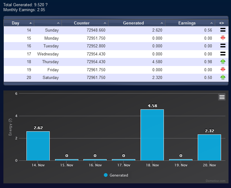

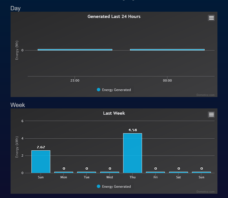

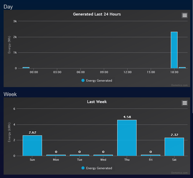

At the moment the last value is still visible, but it might disappear this night. I don't know why Sunday's and Thursday's values are still here and the other values not. The values I entered can be seen in the attachment below (Table "Meter_Calendar"). Today I entered 72964070

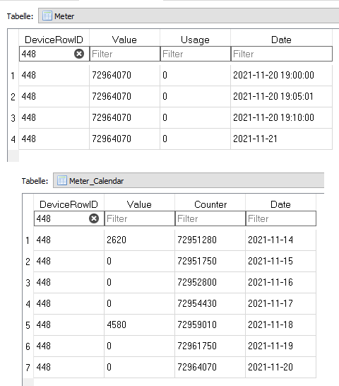

In the sqlite Database I have this situation
Is it possible that the database entry in the table "Meter" without the timestamp is deleting the usage at midnight? And so the value "0" is transported into the table "Meter_Calendar"? But why?

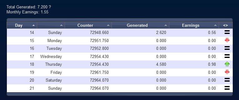

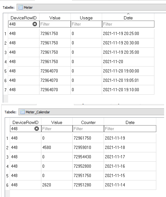

As expected: I got an automatic entry probably at midnight into the database table "Meter". Now my usage values from yesterday have disappeared this morning:
