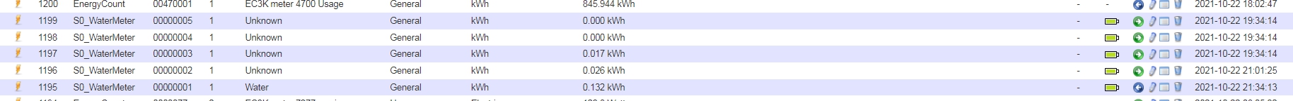

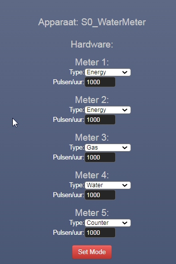

Hey
I have connected a 5 channel S0 counter module (S0-PMC-5) via usb.
On channel 1 there is a water meter that gives neat pulses.
Now in domoticz I want to set this meter to water instead of energy.
This doesn't want to. Does anyone know if this is possible?

Hello Forum members
just an update.
The S0 counter now works fine, I was not shown the correct counter, the reason for this was that the hardware must allow new sensors.
So first set counter type, and then allow 5 min new sensors.
Then you see the correctly set counters.
