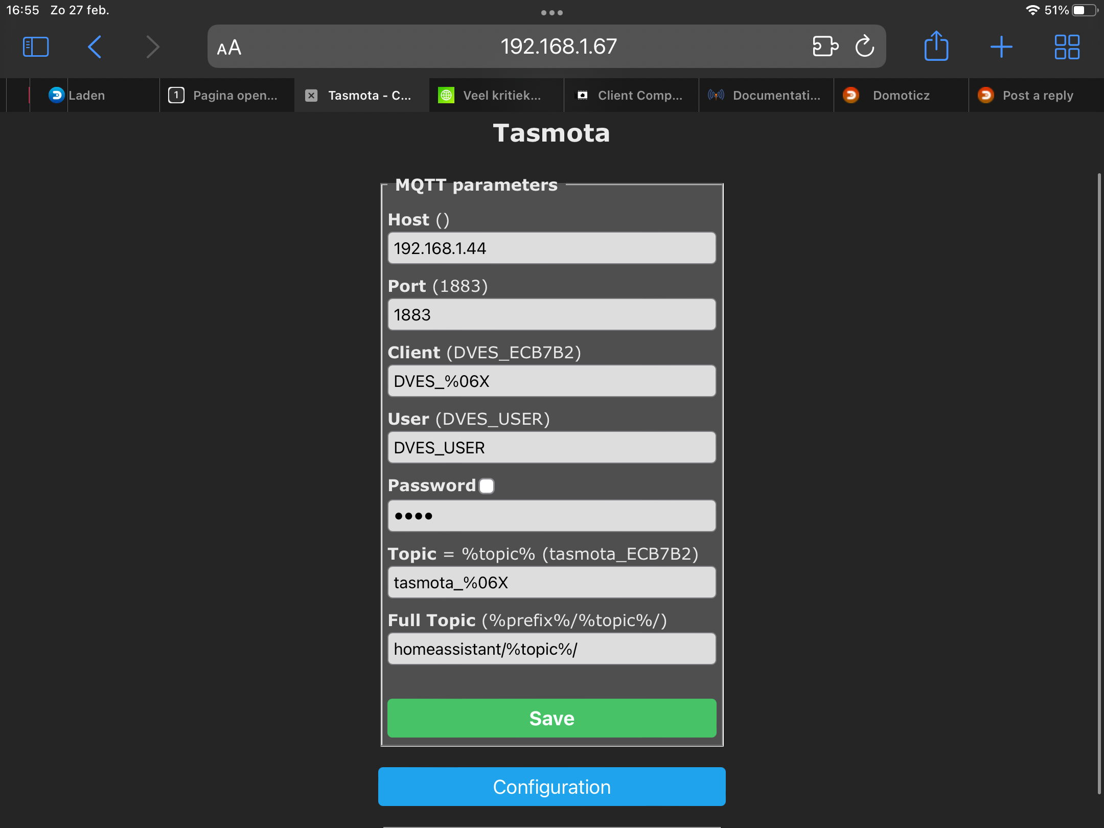

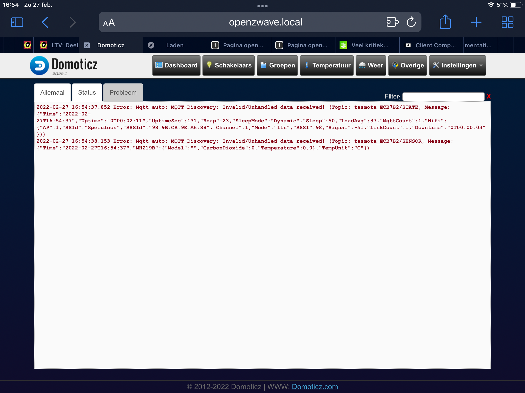

I have an espeasy co2 sensor. Mqtt. Autodiscover.
It gives errors though, in 2022.1
Any suggestions?
Any suggestions?

You are using Tasmota and not EspEasy. Look/search in Tasmota for set option 19 to get this running with MQTT Autodiscover.Ries wrote: Sunday 27 February 2022 16:56 I have an espeasy co2 sensor. Mqtt. Autodiscover.
Any suggestions?
