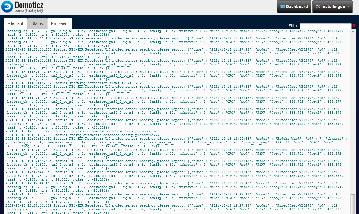

It seems that the RTL-SDR driver has been updated and Domoticz not yet.
Domotics does not know this Air quality sensor for measuring the 2.5um particles but the RTL-SDR "driver" does. It relays it properly to Domoticz but Domoticz does not know how to handle it. Someone please update this in Domoticz. I use this sensor now thru mqtt but would be nice it I could leave out this step and use the sensor directly with the Domoticz RTL-SDR hardware interface.
2021-10-13 11:27:44.137 Status: RTL-SDR Receiver: Unhandled sensor reading, please report: ({"time" : "2021-10-13 11:27:43", "model" : "Fineoffset-WH0290", "id" : 152, "battery_ok" : 0.600, "pm2_5_ug_m3" : 5, "estimated_pm10_0_ug_m3" : 6, "family" : 65, "unknown1" : 0, "mic" : "CRC", "mod" : "FSK", "freq1" : 433.951, "freq2" : 433.892, "rssi" : -0.101, "snr" : 19.466, "noise" : -19.567})
Unhandled air quality sensor 2.5um
