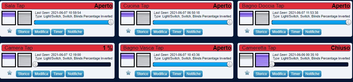

hi, i was on domoticz stable version and i was using zwave since long time without issue.
Since yesterday my devices have been hot responding anymore.
i try to update to latest beta version but it not change.
i see that in harware page the zwave config button is become red (it was blue)
Immagine 2021-09-19 122714.jpg (101.59 KiB) Viewed 683 times
i have razberry zwave GPIO board 1st version.
i created bot ttyAMA0 and also ttyUSB0
the one that was working is ttyAMA0
today i create the ttyUSB0 but nothing change: configuration button still red and device are not responding:
Immagine 2021-09-19 123334.jpg (116.51 KiB) Viewed 683 times
this is the log:
