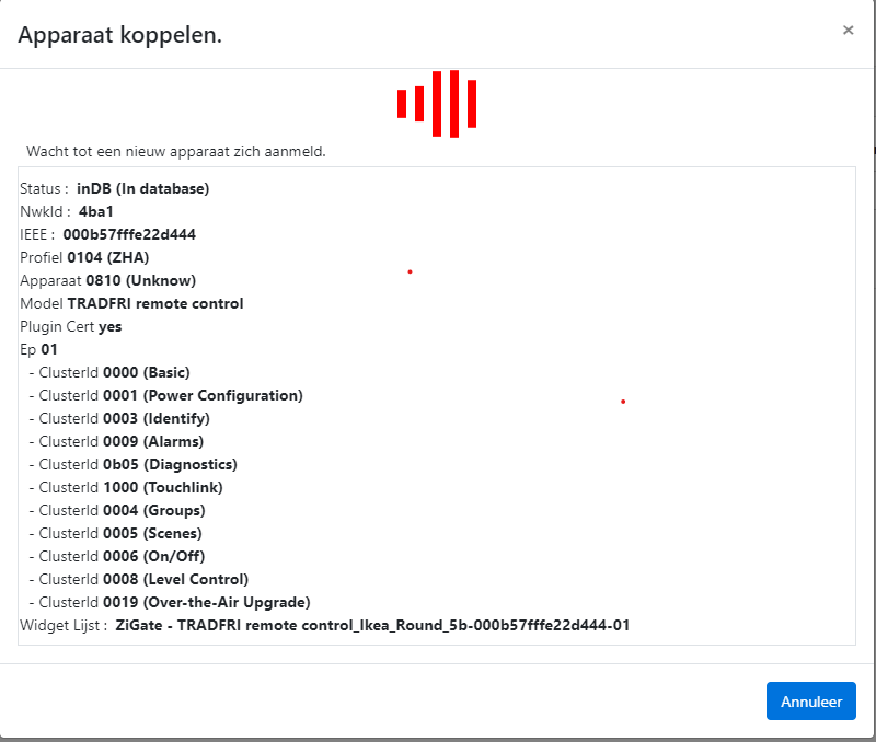

With my new ZiGate running on a Windows 10 machine I tried to pair with a TRADFRI Remote. That was succesfull, see attached images. It was recegnised in the Plugin, and it appears as a Domoticz device. However, after that, I can push buttons what I want, nothing is happening. The device is not reacting, I see no activity in the Domotiz logging. Anyone familiair with this problem?

That is normal behavior for these kind of remotes.
You have to bind them to a group and then it can be used. See the zigate wiki https://github.com/pipiche38/Domoticz-Z ... te-control
