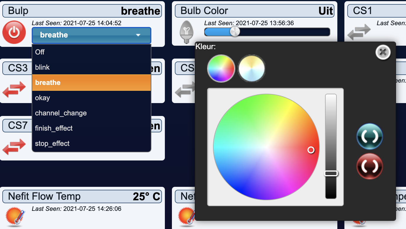

I have a ZB-RGBCW Zigbee 3.0 LED-bulb, RGBW LED wich is seen by Domoticz as an RGB light and with the slider you can adjust the brightness and with an other button you can adjust color and switch on/off. Also different effects can be selected (Blink, Breath, Stop/Finish effect) . I called the light Bulp
I would like to address different colors to different actions:

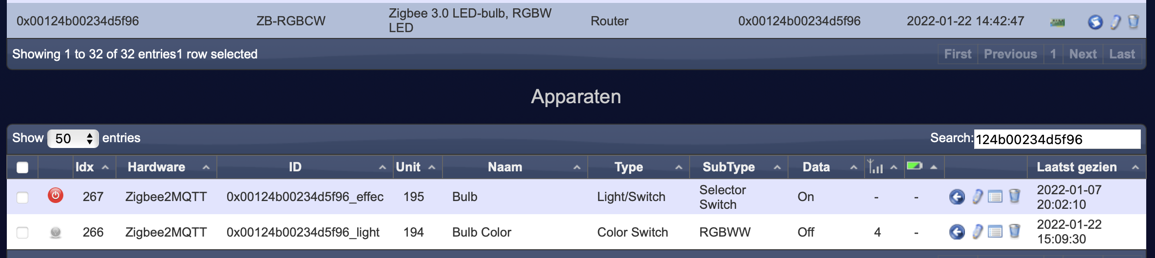

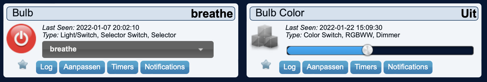

I have a new problem after fresh installing domoticz, restoring old database and re-pairing all the zigbee devices.
There is only 1 device shown (Bull-Color), as there were 2 in the "old/before crash" situation (Bulb and Bulb-Color)
With the Breathe option the light went fading on and off just as breathing, but the device is not available after pairing.
Is there a device list (some config file) where I can the setting of the "breathe" ?
I have a copy of the old data in which I could retain old data
The Old situation
After reinstalling domoticz and re-pairing
The Old situation
