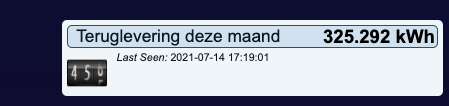

For people who want to know what they returned in total trough their smart meter... Here is the solution. It adds up the value for return1 and return2 (high and low) The base from the code I borrowed here on the forum, no idea who made the original... But this one is adapted to calculate the total monthly return instead of the total monthly consumption.
Just a tip for future users, It costed me 4 nights to find out... the r1 and r2 in the code are return1 and return2... In the original code it said v and v2 which are the numbers for the power consumption high and low...
NOTE! This is the ACTUAL returned value, not what you used right away but what went through the smart meter and is deducted from your total monthly consumption (at least in the Netherlands it works like that for how long it will last)
The return value will look like this:
Schermafbeelding 2021-07-14 om 17.19.49.png (21.03 KiB) Viewed 1603 times
