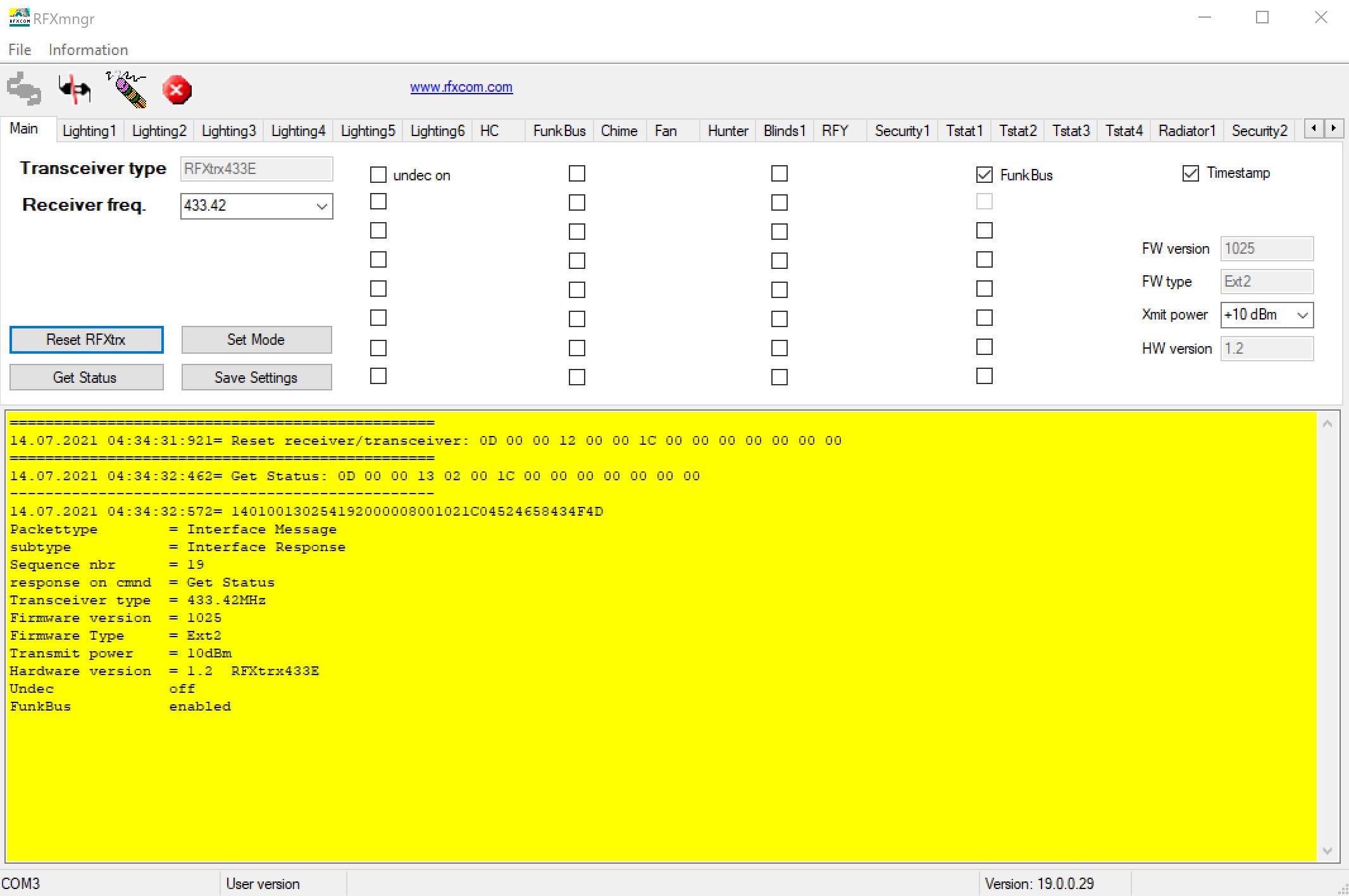

After trying to update via domoticz the RFXTrx33E device configuration the RFXTrx33e keeps in invalid state :(
I'm able to flash other firmware version and I connect with rfxmngr, but the rfxmng does not recognize the configuation & I can't update the configuration. (disconnection of USB or "Reset RFXtrx" does not help, too.
Any ideas how to get an valid configuration and working device again ?

select 433.92 and click Set Mode and Save Settings
Thank you very much - problem has been solved !
Quite easy , I didn't see that the frequency was wrong :oops:
