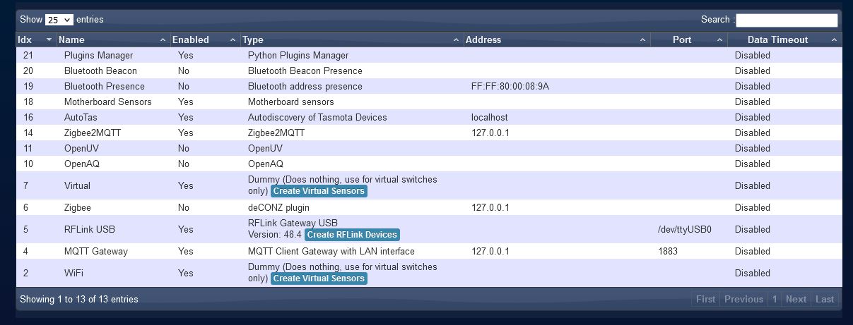

To be sure: did you try it to use 127.0.0.1 as IP address instead of localhost in the MQTT hardware configuration?
And the conclusion was that it did not work?
And what if you fill in the IP address of your Domoticz server?

localhost and 127.0.0.1 dont work.

localhost used to work. Is mosquitto listening to localhost? You can check this with mosquito_pub
Edit: localhost within a Domoticz docker will only look to mosquitto in the Domoticz docker. Mosquito is on another docker...
