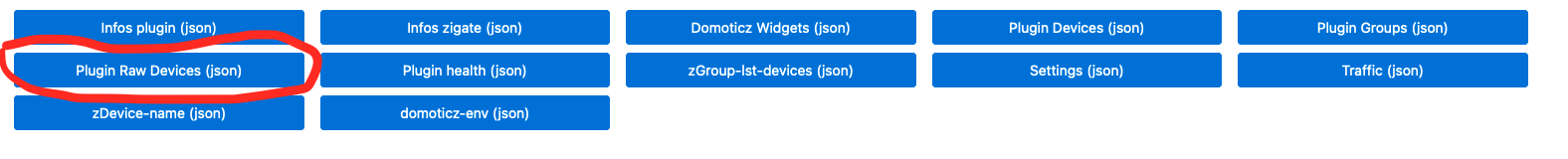

Screenshot 2021-06-08 at 22.15.15.png (38.34 KiB) Viewed 2138 times
please help me in just publishing what I need, I have no clue what is on your dropbox.
I simply need the export . You might have to add a .txt extension in order to upload here
