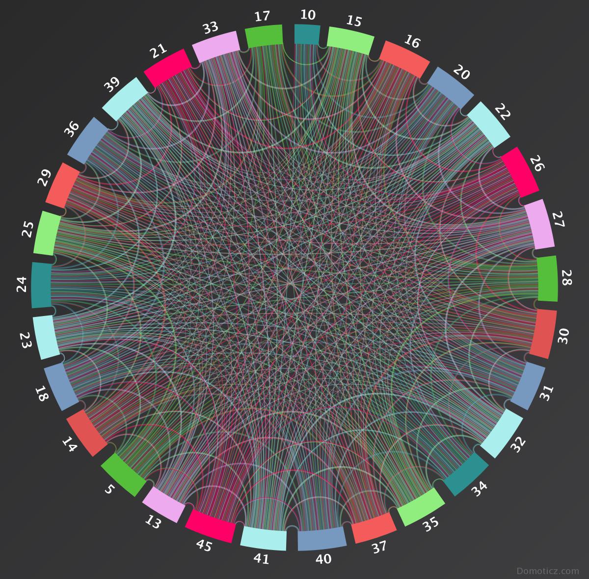

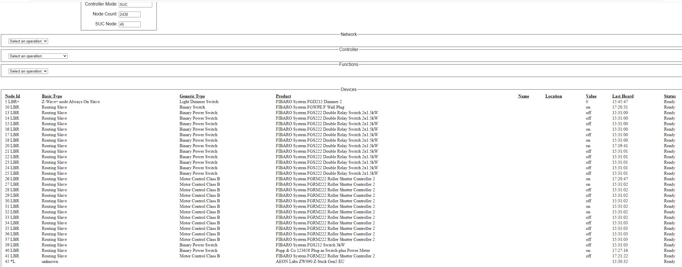

My issue is that the items didnt send their "push info" to the controller. I refress one-one device on the OpenZWave Control Panel and get the state and value, but it was working automatically in the previous setup. I dont know if it is important but the controller (now the Aeotec gen5 stick) is 45. item, not the first one. I feel the devices would send their update to ID 1 or something else.

Infor from OpenZWave Control Panel:
Controller Mode: SUC
Node Count: 2430
SUC Node: 45
I have added 2 JPG as nodes on chart and as table.
Can anyone help me what should I do to get the items reporting their state and values as those should?

It seems the root cause was the grouping and also the X.Y group numbering. Old controller was on node 1 and all device lifeline grouped to node 1. I followed this thread: viewtopic.php?f=24&t=29715#p225812
And just removed all false node IDs, and set my controller's ID (45).
Seems OK, just testing a bit.
