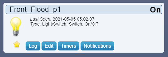

In Domoticz, when i first open it up after a day /or a few hours -- there is a difference between what Domoticz shows, and what a devices real state is in OZW:
Screenshot 2021-05-05 083432.png (19.96 KiB) Viewed 354 times

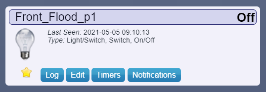

In OZW:
Screenshot 2021-05-05 0909332.png (11.99 KiB) Viewed 354 times
I then turn the device off in Domoticz, by pressing the light symbol:
Which is passed on to OZW.
Changing values in OZW - is updated immediately in Domoticz. Set it to ON in OZW, it changes live in domoticz.
The problem seems to be when you first load/open Domoticz
Nearly every z-wave device is showing as "ON" in switches, despite being off in OZW.
Every device was "Last heard" in OZW at: 5:03:42 AM
This is also correctly shown in Domoticz as "Last Seen"
So the date is being correctly synced. But in the "LOG" in each device in Domoticz, the last entry is wrong...
2021-05-05 05:02:17 - On - zstick
Domoticz thinks that an "ON" command was sent from the zstick at the 5AM time - which it was not.
