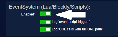

Please check if you set the event system to active. [Setup][Settings][Other]arhtur wrote: Tuesday 04 May 2021 23:44 The python-dev removes the logs problems but still Python Version: None in the About page and MQTT still didn't work even after a reboot of the server.
If it is not set you will see
On the about page and you will not see any reference to the Python EventSystem or to the (Python) PluginSystem n the domoticz log.
MQTT in domoticz is not depending on Python so if MQTT does not work it is because of another reason.

The event system is active
