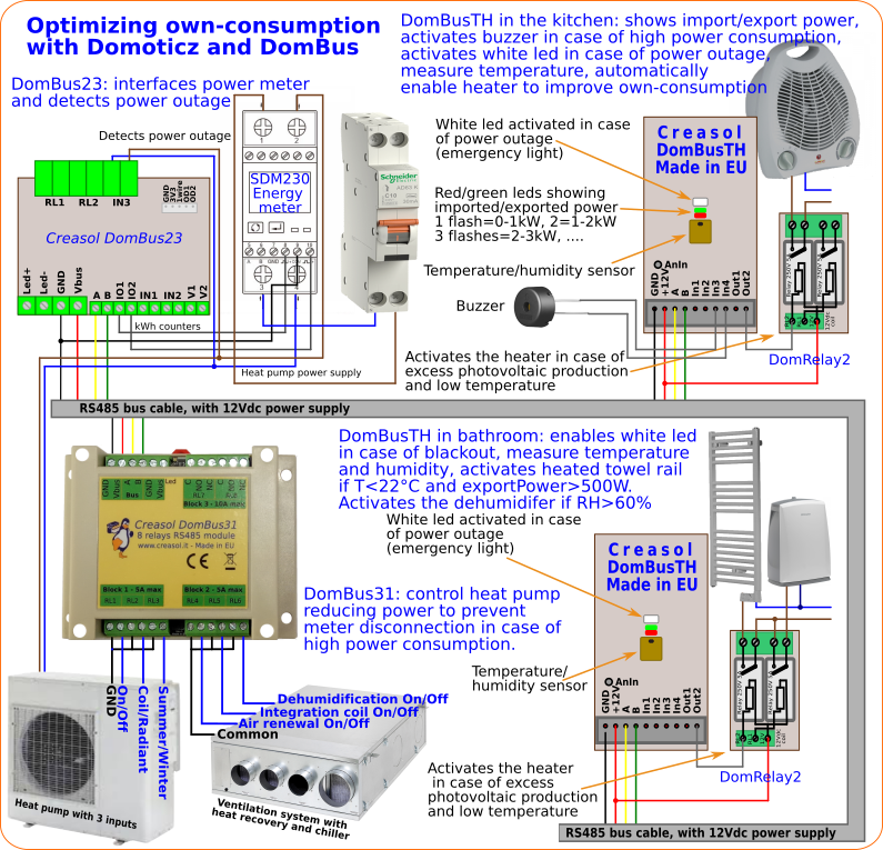

I've written a LUA script for Domoticz that add the following functions to Domoticz:
* power outage detect => turns on Leds (and other devices) in case of blackout (power failure)
* import and export power displaying, through red/green leds on DomBusTH (red led flashes 1 time if import power <1kW, 2 times if <2kW, ... green led flashes 1 time if export power <1kW, 2 times if power < 2kW, ....)
* in case of high power usage, program heat pump to work at lower level, or disconnect loads to prevent power disconnect. In case there are not any load that can be disconnect, send alert through leds/buzzer/siren, and send alert by Telegram
* automatically enable loads in case of extra power from renewable sources, to increase the own-consuming: for example activate an electric heater if temperature is below a level and available power is greater than heater power.

For those who use windows, just install the files script_device_power.lua config_power.lua globalvariables.lua globalfunctions.lua from https://github.com/CreasolTech/domoticz_lua_scripts to the domoticz/scripts/lua folder and edit those files to meet your home automation system.
Below a schema that resumes what the script does: obviously, it works with any device supported by Domoticz.
