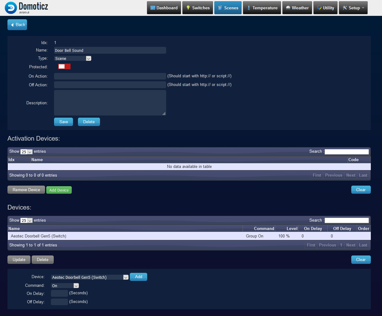

I have a AEON Labs (Aeotec) ZW056 Doorbell Gen5+.
I'd like it to ring on the activation of a scene. I did that. When it plays it kind of repeats the first half-second of the audio 6 to 7 times and then it continues playing the whole audio file. If I use the button that came with the doorbell, and press it, the audio plays normally.
Is there a way to play the sound via a scene, so it plays normally?
For now I activate the scene from the web interface. Later I'll use a remote to activate the scene.
Also tried:
Created a blocky script to ring the doorbell when a light switch is turned on: Same problem with the glitchy sound.
Details below:
2021-04-26 22_06_07-Domoticz — Mozilla Firefox.png (7.15 KiB) Viewed 537 times
2021-04-26 22_04_49-Domoticz — Mozilla Firefox.png (63.65 KiB) Viewed 537 times
2021-04-26 22_07_38-Domoticz — Mozilla Firefox.png (12.19 KiB) Viewed 537 times

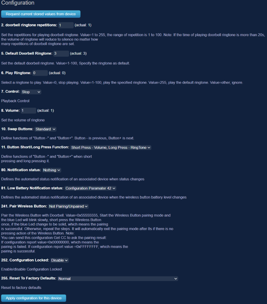

2021-04-27 20_12_29-.png (285.4 KiB) Viewed 518 times
One of the settings is : 6. Play Ringtone
It seems that it'd be possible to issue a command to play a specific ringtone.
From the GUI I go at : Setup: Hardware: Z-Wave: Setup: Drop-Down box: Control Panel: Select the Doorbell: Current Values: Play Ringtone:
There I enter 1 or 2 or 3 or etc and hit "Submit" and it plays the selected ringtone perfectly without any glitches. (See screenshot below)
Is there a way to issue that "Play Ringtone" command elsewhere from the GUI or from a simple script (Blockly preferably)?
2021-04-27 20_47_55-OpenZWave Control Panel — Mozilla Firefox.png (46.09 KiB) Viewed 518 times

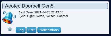

Here's how I activate the DoorBell via Domoticz and Z-wave.
1st way:
I just click the Bell icon (Domoticz: Switches)
2021-04-28 22_45_31-Domoticz — Mozilla Firefox.png (9.13 KiB) Viewed 505 times
