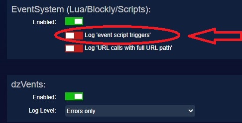

Re: Howto remove status from log
Arjan2019 wrote: Monday 19 April 2021 9:29 So is there away to prevent it from being in the log?
Yes
[Setup][Settings][Other]

Complete over look that setting thanks
