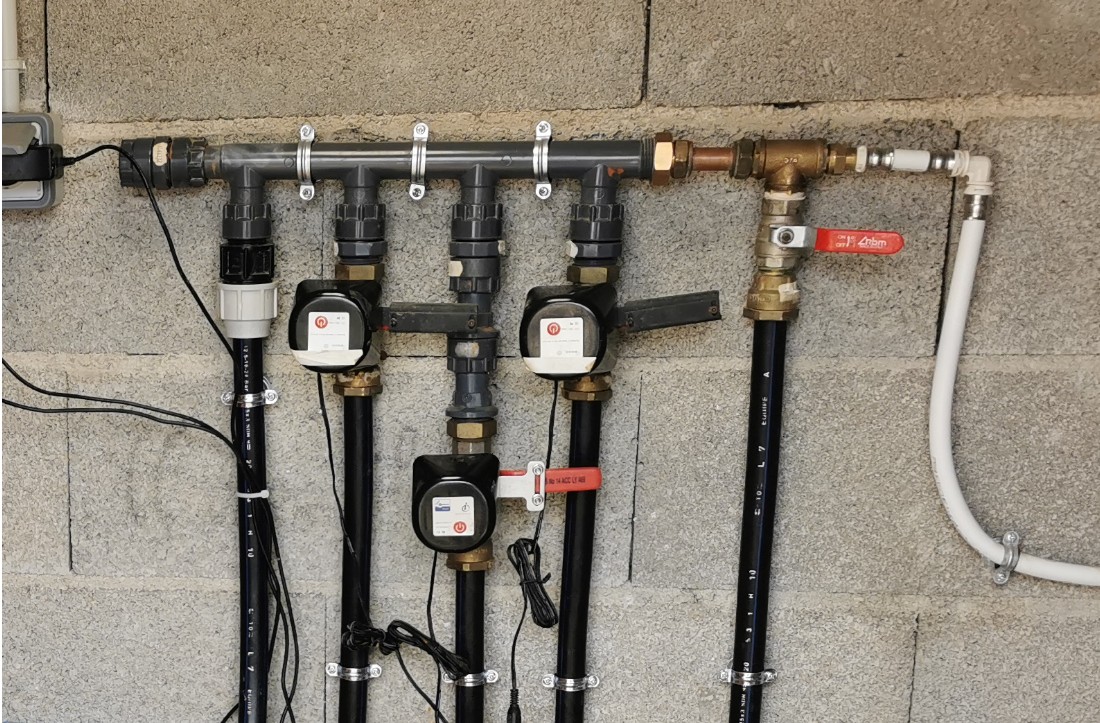

To water my garden I use 3 devices like that one :
https://fr.aliexpress.com/item/10050015 ... web201603_
It figures out that, a night, one of them stayed in "on" position, despite the timer order to turn off. So I decided to add twice the order to turn off, just in case, in the scheduler.

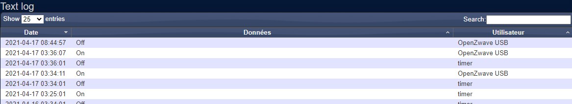

This morning I woke up and the same was still up. In the text log here is what I see :
So the timer asks to turn off, but I do not understand why this openzwave usb asks to turn on. The last one at 8 o'clock is me pushing the button on the device.
Any idea how I could fix that ?
