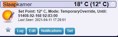

sidepipe wrote: Sunday 11 April 2021 17:02 Just the normal API call for a temporary override but without specifying a time, so for example in dzVents:
I applied your patch and tried the command but it does not work on my system. It shows something like below until the next cycle and then return to the schedule known to evoHome.

Re: Temporary Override Until Next Switchpoint
sidepipe wrote: Sunday 11 April 2021 18:29 Edit: the web API device then fixes itself next time it's read from the server.
I have the web API and the until time get removed in the next cycle but the fix set it to the state set by my schedule.
The domoticz code has no information on the date/time of the next switch time.
