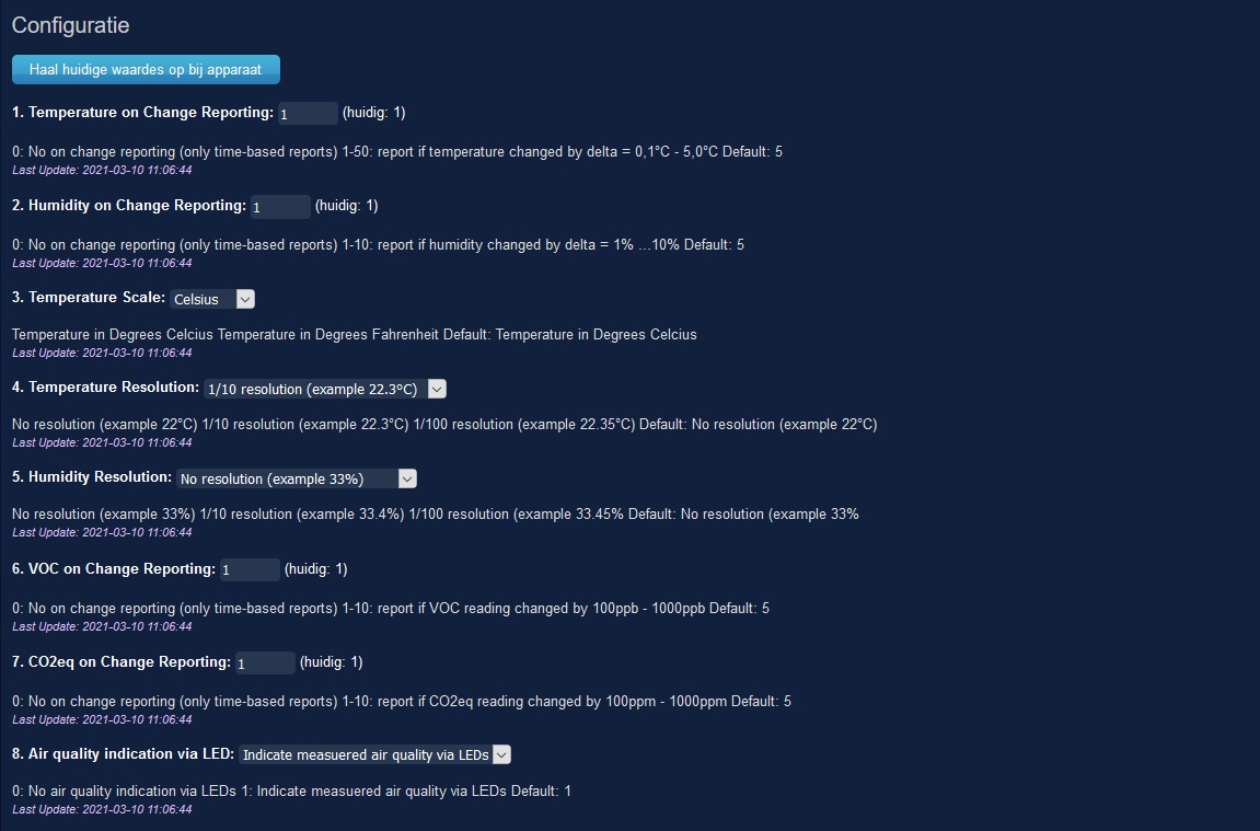

Configuration:
Configuration-Luftgütesensor Z-Wave Plus (VOC-Sensor).jpg (158.5 KiB) Viewed 3969 times

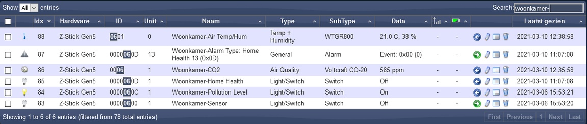

Devices
Yes, the VOC device is missing; EUROtronic had no answer for this issue...
Devices-Luftgütesensor Z-Wave Plus (VOC-Sensor).jpg (99.06 KiB) Viewed 3969 times
