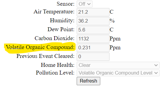

I've bought this air quality sensor: https://eurotronic.org/produkte/sensore ... etesensor/
It's supposed to measure CO2 and VOC (a.o.), although the VOC sensor does not appear in Domoticz. It's not added to the devices tab automatically.
However, when going to the control panel of my Z-wave plus controller, the VOC sensor/value can be found (see attachment).
Does anyone know why this sensor is not added automatically? And is there another way to see the values in Domoticz?

I have the same problem. Sensor added 6 devices but VOC was not there.

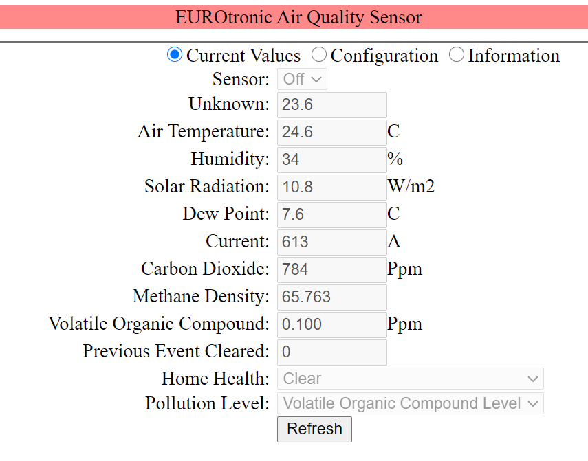

Re: VOC sensor not available in Domoticz
All of a sudden my Eurotronic Z-wave plus sensor is starting to get more values. Does that happen to anyone else as well?
Also the VOC sensor is giving multiple values. Sometimes the low 0.100 value and sometimes like 36.096. I think it measures different kind of chemicals.
Nevermind. I think it was a bug. I did a reset and all is normal again.
