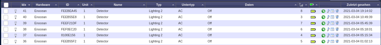

Hello I run into problems with my setup. For a couple of months my system runs stabil. Now first it starts to loose some signals from window switches and now I can't get any signal from the switches. When switching a eltako window switch I see a small diode on USB ESP3 is going on so it looks like the signal runs to the ESP3. I got some strange devices in my device list.
Strange devices
Strange devices
Bildschirmfoto vom 2021-03-06 07-52-27.png (56.58 KiB) Viewed 901 times
