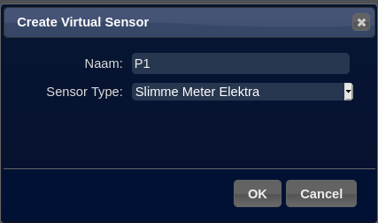

I made a second SM meter using a Wemos powered by the meter.
It sends the different values via MQTT by using different topics.
On a different PI I subscribe to these topics and by using JSON methode they are transmitted to Domoticz.
For the electricity I used the JSON contianing the 6 values..
In Domoticz I choosed the P1 “meter”.
The result is that there is only 1 meter in the devices window.
So I do something wrong. I will post the Python script and the screen dumps of the configuration later this evening.

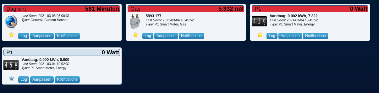

2 more files.

I see, that you have created 2 identical sensors, both called P1. That is very confusing and I'm not sure that it will work correct.
Why is that needed?

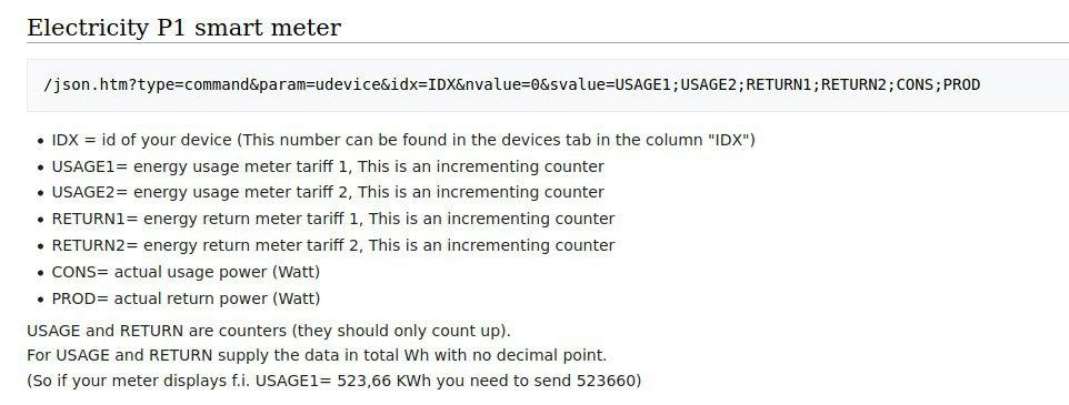

Regarding updating your sensor, have a look into the Wiki https://www.domoticz.com/wiki/Domoticz_ ... n_counters

Why do you say I use 2 identical sensors? If I choose the GAS sensor it is automaticaly part of the P1 meter.

If I look to your screenshot, marked f4.png I see:Why do you say I use 2 identical sensors?
On the first row:
- Custom sensor, called "Daglicht"
- Gas meter, called "Gas"
- P1 Smart Meter, Energy, called P1
All 3 sensors timed out (red bar)
On the second row:
So I see 2 P1 Smart Meter, Energy, called P1.

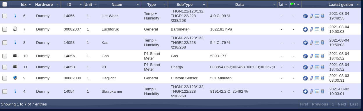

No, you have created the separate virtual sensors yourself. See your screenshot f2.png and IDX 10 (Gas) and 11 (Energy)If I choose the GAS sensor it is automatically part of the P1 meter.
For both the type is P1 Smart Meter, but the sub-type is Gas, resp Energy.
Similar you will see IDX 7 is Type "General" but also IDX 9 is a Custom Sensor with Type General.
I did, but what should I see related to the question?Look at attachement f3.png
But I do not understand what the problem/question is.

I think the problem has been solved. My expectations were different.
I was expecting more meters like a meter for the current usage and a meter for the total of the tarif 1 and tarif 2 values, current and voltage etc...
Sorry for the confusing.
