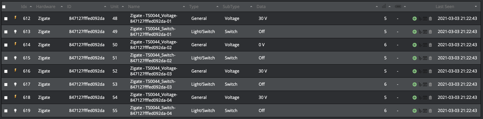

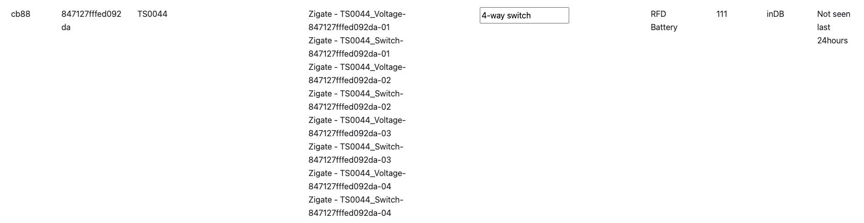

Lately I got a Tuya 4 way switch (TS0044) and latest version of Zigate module recognise it correctly as TS0044 and creates 4 "voltage" devices and 4 "switch" devices in Domoticz.
However - whatever I try - status of switches in devices tab is always "Off" and I have no idea how to detect any change and make Domoticz understand which button I presses once or twice.

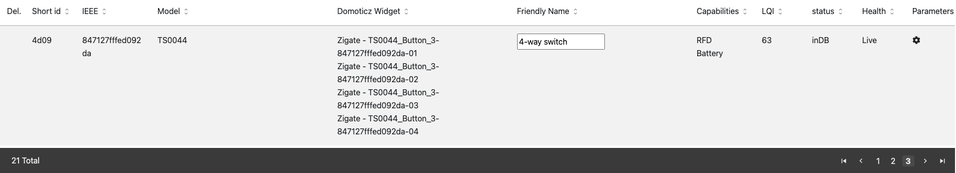

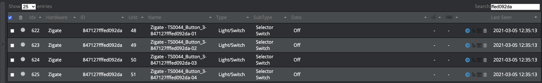

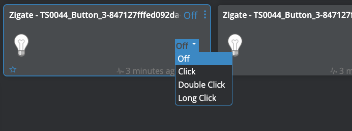

Zigate module recognises it: Now I get just "switch" devices in Devices tab and no Voltage devices: ...and when I include them I get 4 switches with a selector: Here is export JSON:

Whatever I press - the state on Domoticz switches is always Off and doesn't change. Also no sign in domoticz log file that anything was received from the switch, no "UpdateDevice" messages whatsoever.pipiche wrote: Friday 05 March 2021 13:56 what is not working ?
