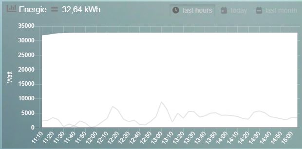

I'm struggeling with my energy graph. IDX 1 is a P1 Smart Meter With LAN. It monitors a 3 fase meter and we also have solar panels.
I would like to see the actual incomming or outgoing power (-3262). Just as the P1 meter is showing in Domoticz.
When adding this code:
// Grafiek: "Energie"
blocks['graph_1'] = {
    devices: [1],
    legend: false,
	datasetColors: ['white'],
	buttonsBorder: 'transparent',
        buttonsColor: '#ccc',
	buttonsFill: 'transparent',
	lineFill:true,
The graph outputs the standing of the consumption that day.

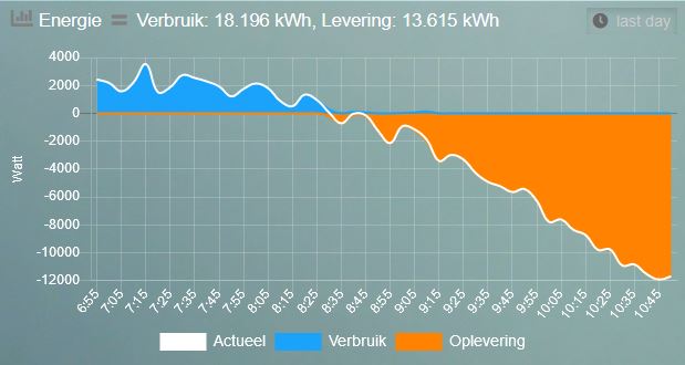

Brutus
Posts: 249
Joined: Friday 26 September 2014 9:33
Re: Energy Graph
Post by Brutus »
@Lokonli
Thnx for your answer. Did look there but had no luck getting it to work now it does.
Used this code:
    title: 'Energie',
    devices: [1],
	graph: ['line','line','line'],
	lineFill:[false, true, true],
	lineTension: 0.4,
	custom : {
        "last day": {
            range: 'day',
            filter: '4 hours',
            data: {
                Actueel: 'd.v_1+d.v2_1-d.r1_1-d.r2_1',
                Verbruik: 'd.v_1+d.v2_1',
                Oplevering: '-d.r1_1-d.r2_1'
	datasetColors: [colourWhite, colourBlueLight, colourOrange],
    legend: true
Result:

Posts: 2292
Re: Energy Graph
Post by Lokonli »
The graph looks quite ok to me.
What would you like to see differently? The data in the header row?
or combine it with the solar data?
(The energy usage seems high. You have a heat pump/electrical heating?)

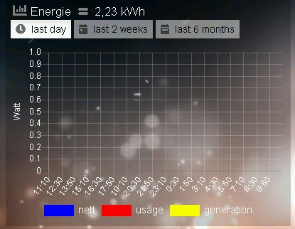

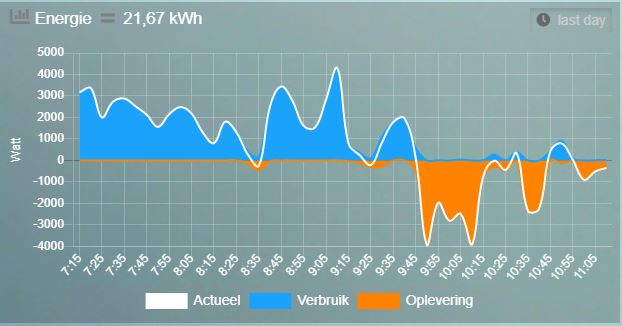

I'm sorry maybe I was not clear about that. Before you pointed me to that link I already looked at that link but could not get the graph working. After you pointed it again to me I looked and got it working as you can see 8-)
This graph is from work. We only have heatpomps and 104 Solar panels recently placed. So I installed Domoticz to get a better look at the Energy standings. With dashticz we can make it even look nice ;) With days like this the graph looks nice:
Now I thought lets do this at home with the same graph because I like it. But... I copied the code from this page:
https://dashticz.readthedocs.io/en/mast ... stom-graph
Modified it to my device:
blocks['graph_77'] = {
    title: 'Energie',
    devices: [77],
    graph: ['line','bar','bar'],
    custom : {
        "last day": {
            range: 'day',
            filter: '24 hours',
            data: {
                nett: 'd.v_77+d.v2_77-d.r1_77-d.r2_77',
                usage: 'd.v_77+d.v2_77',
                generation: '-d.r1_77-d.r2_77'
        "last 2 weeks": {
            range: 'month',
            filter: '14 days',
            data: {
        "last 6 months": {
            range: 'year',
            filter: '6 months',
            data: {
    legend: true,
    datasetColors:['blue','red','yellow']
With this result:
The last day graph is not working. The other two are giving data.
What could be wrong?
Greetings.

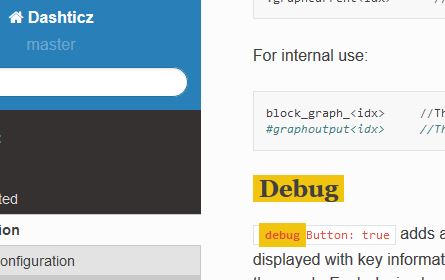

Brutus
Posts: 249
Re: Energy Graph
Post by Brutus »
When using the search option on the Dashticz documentation it creates a space :roll:
Removing the space helps haha. Heres the debug:

Can you remove all r2 and v2 data fields from the custom data definition and retry?
Brutus
Posts: 249
Re: Energy Graph
Post by Brutus »
That did the trick! But I don't have a single tariff meter. Domoticz reads both usage and generation devices...
