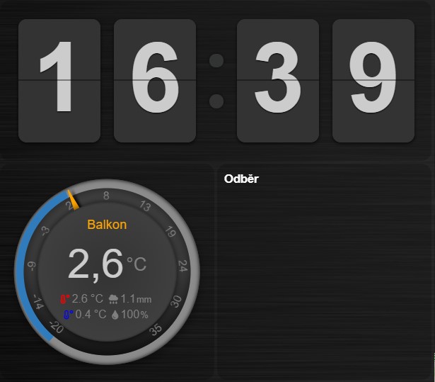

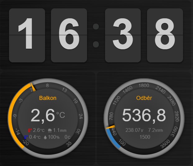

Krenstik
Posts: 45
Joined: Saturday 13 June 2020 12:51
Re: Dashticz v3.7.4 beta
Post by Krenstik »
is a power concuption. In last beta was fully working:
Snímek obrazovky 2021-02-21 163912.jpg (53.83 KiB) Viewed 1105 times
but now I have just name:
Snímek obrazovky 2021-02-21 163940.jpg (43.62 KiB) Viewed 1105 times

app_version: "2020.2 (build 12738)",
result: [
AddjMulti: 1,
AddjMulti2: 1,
AddjValue: 0,
AddjValue2: 0,
BatteryLevel: 255,
CustomImage: 0,
Data: "521.6 Watt",
Description: "",
Favorite: 1,
HardwareDisabled: false,
HardwareID: 6,
HardwareName: "Z-wave",
HardwareType: "OpenZWave USB",
HardwareTypeVal: 21,
HaveTimeout: false,
LastUpdate: "2021-02-21 16:40:35",
Name: "Spotřeba komplet",
Notifications: "false",
PlanID: "9",
PlanIDs: [
9
Protected: false,
ShowNotifications: true,
SignalLevel: "-",
SubType: "Electric",
Timers: "false",
Type: "Usage",
TypeImg: "current",
Unit: 2,
Used: 1,
XOffset: "767",
YOffset: "148",
idx: "66"
status: "OK",
title: "Devices"
and dial:
blocks['spotreba'] =    {      type: 'dial', title: 'Odběr', width: 6, min: 100, max: 3500, showunit: false, shownumbers: true, last_update:false, showring: true,
        values : [  { value: 'Data', idx: 66  },
			{ value:'Data', idx: 63,  },
			{ value:'CounterToday', idx: 65,           },]}
I can reproduce your issue if you have defined the following in CONFIG.js:
config['use_favorites'] = 1
In this case, Dashticz doesn't receive the information for device 63 and device 65, since they are not marked as favorite in Domoticz.
So, change this setting to:
config['use_favorites'] = 0
In the mean time, I've improved the dial error handling in latest beta, so at least you see some info when this error occurs.
Can you test with latest beta?
I do not have it in the config at all, but anyway if I add to confing this not help..
But select those two Domoticz as a favourite help. ;-)
Thank you.
For sure, the latest beta, I´ve updated now. ;-)
And regarding setpoint for ppm, or this power consumption?
Lokonli
Posts: 2292
Post by Lokonli »
Krenstik wrote: Sunday 21 February 2021 22:56 And regarding setpoint for ppm, or this power consumption?
Should work in latest beta. Can you test?
Krenstik
Posts: 45
Post by Krenstik »
Snímek obrazovky 2021-02-23 184359.jpg (270.49 KiB) Viewed 1021 times
Working well.
NIce ;-) Thank you.

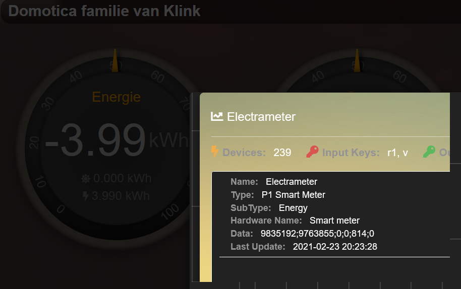

Post by pvklink »
I have the latest beta running without any problems.
I have several dials, and want to get my p1 dial ok.
Its a dial for a energie p1 device with two meters, day and night
I like to show the two values/data 9835192 and 9763855 instead of -3.99 it is showing now..
Can somebody give me a hint how to acomplish this?
Jablotron connection, Ikea
Lokonli
Posts: 2292
Post by Lokonli »
pvklink wrote: Tuesday 23 February 2021 20:30 I have the latest beta running without any problems.
Add the following to your block:
  values:['Counter', 'CounterDeliv']
Also see:
https://dashticz.readthedocs.io/en/beta ... neric-dial
