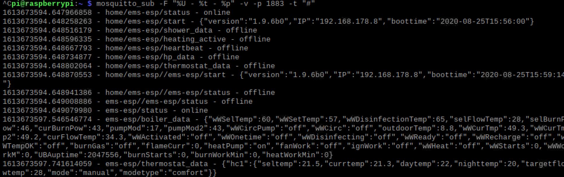

It could also be helpful to see what is send from your airco to domoticz. If it is send via MQTT you can inspect what is send with
mosquitto_sub -F "%U - %t - %p" -v -p 1883 -t "#"

I send you the MOTT asap.

Hi Waaren, the only MOTT client who's exchange data with Domoticz is my EMS/ESP module for my heatpump. ( see attachment)

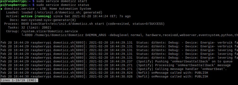

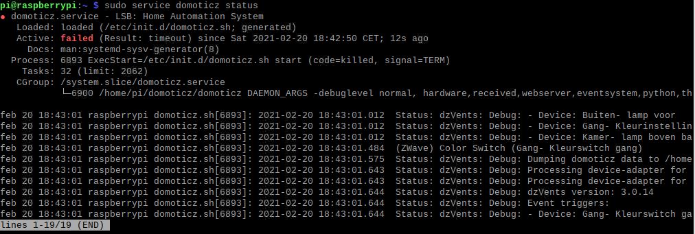

Hi Waaren, in a effort to start debugging with a clean logfile something went wrong. I could not empty the file in the linux enviroment (not enough knowledge) so I stopped the domoticz service and copied the logfile to my windows pc, emptied the file and try to transfer it back to domoticz.
I have now a 0 Kb logfile. After that I started the deamon and domoticz services and then tried sudo trial -f var/log/domoticz.log. I see the cursor hangs and when I check the status of the domoticz service it says "killed". So I restart the domoticz service and it is up and running but my logfile remains empty.
Is this something witch can be fixed? I feel really stupid right now because this frustrates the proces in hopefully retrieving the main problem. :oops:
Piet
Re: Daikin airco makes Domoticz crash
Bospieper wrote: Saturday 20 February 2021 10:33 Is this something witch can be fixed? I feel really stupid right now because this frustrates the proces in hopefully retrieving the main problem. :oops:
Did you try below commands?
sudo service domoticz stop
sudo rm /var/log/domoticz.log
sudo service domoticz start
Bospieper
Posts: 174
Joined: Thursday 07 November 2019 10:26
Domoticz version: 2022.1
Post by Bospieper »
no I didn't and yes I did now with the results in the attachment. At first nothing happend after the stop, rm and start. The cursor stayed at the left corner for at least 5 minutes then I interrupted the process with CTRL+C. After that I restart domoticz and its now up and running.
Unfortunately there's no domoticz.log in the /var/log/
Piet
