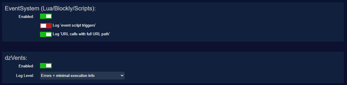

plugge wrote: Wednesday 17 February 2021 0:19 I would like to suggest to make log lines about Status Script event triggered more intelligible by including the script name.
Did you try to set below in settings - other ?
log settings.jpg (26.4 KiB) Viewed 1054 times

waaren wrote: Wednesday 17 February 2021 0:26
Yes, I did. And I mentioned it in the post.
It triples the amount of log lines.
Re: Make "Status: EventSystem: Script event triggered:" log more intelligible
plugge wrote: Wednesday 17 February 2021 0:29 It triples the amount of log lines.
Maybe I miss something but if I use this setting I don't see the behavior you describe. Can you please show what kind of extra loglines you see?
plugge wrote: Wednesday 17 February 2021 0:36 One line would do the job if the script name is included.
Addendum:
I do like to log that scripts are executed, so I keep "Log 'event script triggers'" On. But it would be more informative if it included the script name.
If you use the settings I advised you should not see below type of line
2021-02-17 00:23:00.212 Status: EventSystem: Script event triggered: D:\Program Files (x86)\Domoticz\dzVents\runtime\dzVents.lua
The reason that you see two times the line
 ------ Start internal script: tesyStatus: HTTPResponse: "status"
is that it is triggered twice; so not much you can do about that.
If you want to keep the logline for "EventSystem: Script event triggered" then you will have to live with this for you useless information. The domoticz eventSystem only sees dzVents.lua
The dzVents user scripts, when triggered, are only visible to dzVents and not for the EventSystem.
