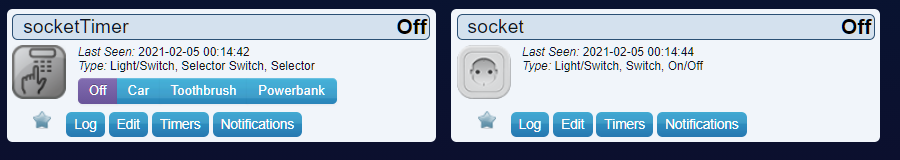

You can do something that gets close to this by creating a virtual selector with the various labels (headphones, toothbrush, car, etc.. ) and use a script to power the socket for the set time based on the selector level chosen.
in dzVents it could look like below script

11master
Joined: Thursday 04 February 2021 22:35
Re: delayed shutdown and input user data pop-up window
Post by 11master »
Thanks for the answer. I thought of creating as many switches as tasks, plugging them into one socket and that's it. But your solution is much more elegant.
I'm just surprised that none of the scripts can use pop ups - maybe in the future :)
I'm getting to reading about dzVents and testing the script. Thanks. :!:
Added:
Summarizing. I spent almost 2 hours learning it all. There is an error in the script:
It is: "afterMin (item.levelName)"
should be: "afterMin (choices [item.levelName])" :)
At least I learned something new. Thanks!
Added:
I changed your script a bit by moving the selector disable fragment right after socket.switchOff (). Now you can immediately see what is happening with the socket.
Can I know where you got the extra icons from?
