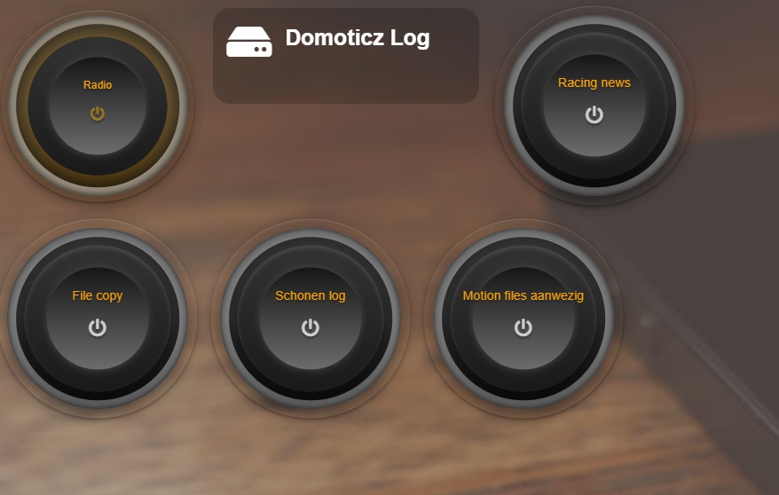

Ok, i made dummy domoticz devices with a dashtics dial type
See my radio and racing news button.
I had two options
1. A domoticz push on type
2. A domoticz switch (on/off)
Ad1. When i choose this type is goes off after pushing, but i also get data in the button and a needle in the ring that i dont need,
Question: can i set these off?
Ad2. (I choose for this option) i get the dial as included in the attachment. I dont want te dial to turn on or off.
Question: Is it possibe to set the on colors the same as the off ?
i now use:
.dt_content .dial {background-color: rgb(119,110,97) }
Can i use the DIAL option also for the log block? because this has no IDX see my attachment ?
If this isnt an option, i will the call the log with the dummy device option (via a http call to domoticz/#/log)

Try a domoticz scene. add:
idx: 's123'
with 123 the domoticz scene number. The scene will stay on.
I see there is a bug: the dial should stay in the 'on' state, but it switches to off. I'll fix that.
For the log, try:
   blocks['logdial'] = {
       idx: 's123',   //your dummy scene
      type: 'dial',
      popup: 'log'

log is working !

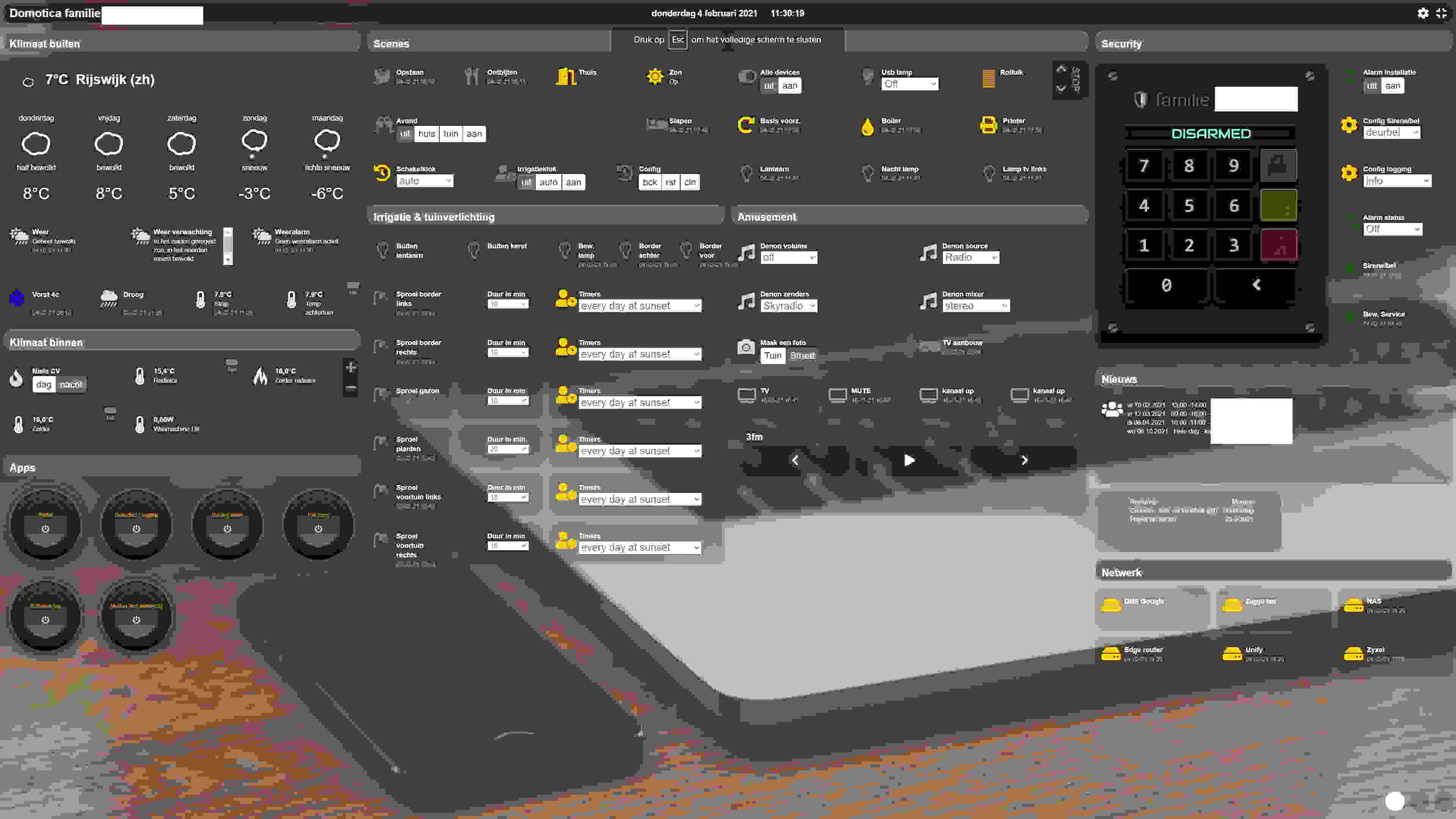

Last item, then i can close the 'dossier' dial for my buttons (and indeed the on-state with s123 does not work as you said...
In my current dashboard it is not visble enough to see if a dial device is on, so there a multiple solutions:
a) by color (preferred)
i can define the outer ring by
.dt_content .dial {background-color: rgb(119,110,97) } /* rgb(119,110,97) dit is buitenring niet de aan/uit ring */
QUESTION:
How do i define the second ring color from a dial type for 1 device that is changed by on/off ? I searched the documentation, but cant find it
b by text
QUESTION:
Another thing is how to change the title or data when a DIAL is on or off
i tried two options and both dont work
a) TextOn blocks[1749] = {title: 'Motion files aanwezig', type: 'dial', TextOn: 'aaa', TextOff: 'bbbb', width: 3}
b) script
function getStatus_1749(idx,value,device)
{if (device.Data == "On") {blocks[1749]['title'] = "XXX"}
else {blocks[1474]['title'] = "YYYY"}}
Current dashboard with dials (en more dials to go)
Jablotron connection, Ikea
