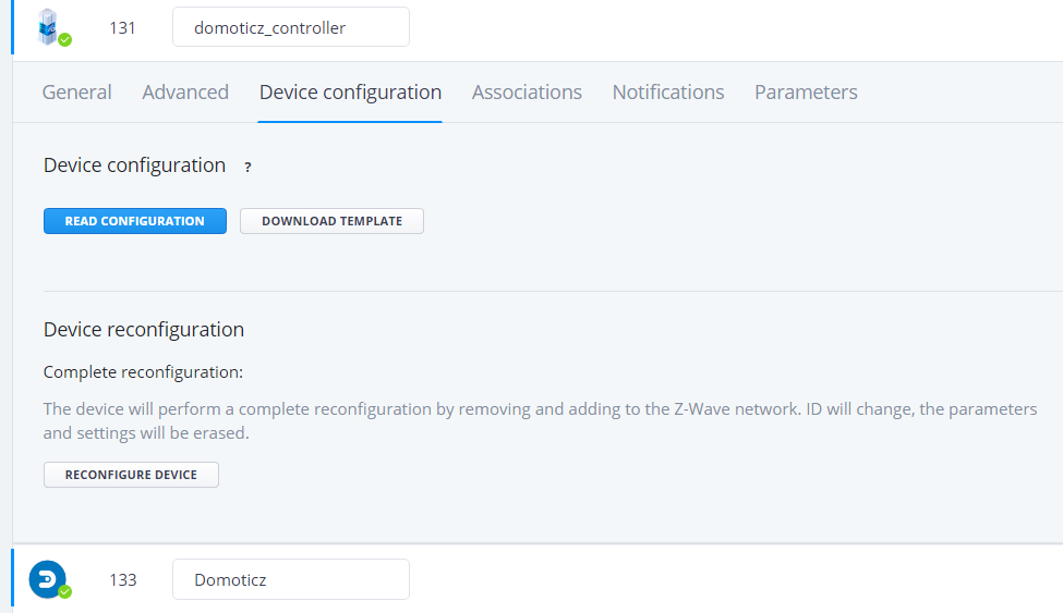

Maybe there are other ways, but what worked for me was using the Simplicity Studio tool on my Windows laptop to fix the issue.
  • De-activate Z-wave hardware in Domoticz, and move the stick to your Windows computer
  • Start the Simplicity Studio 5 software, and in the Tools menu, you can find the "PC Z-wave controller" module. I found it difficult to find, in settings select the right COM port ofcourse.
  • In this tool I could see that all my nodes where somehow present in the stick and that Domoticz was indeed a secondary controller. In the summary section, I saw the message 32 nodes.
  • Next, in the Fibaro HC3, I selected "re-configure" device, whilst my stick was still in the lap-top
  • This did the trick (I believe) and I got the green checkmarks, and "Z-wave fully configured" in the Diagnostics page.
  • As a finishing touch, I added the Domoticz icon to my controller
  • Time to move the stick back to Domoticz and activate the hardware again
  • About 10 min. later I could see the node list in the Hardware section, and over a 100 Z-wave devices were added to the device list

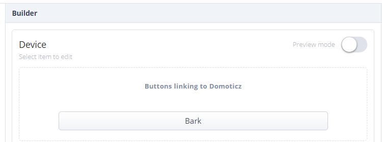

4) Controlling Domoticz devices from within HomeCenter 3
Last part, controlling Domoticz from HC3. For this I used the QuickApp functionality which is newly introduced in HC3. In the devices section in HC3, in 'other', you can add a QuickApp. I used the 'Binary Switch" for starters, but maybe something else is more suitable.
Also the functionality below is still very basic, and looking forward to other idea's this might give to you.
In the "Edit&Preview" section of your QuickApp. Click om Edit. This brings you the Builder. On the left hand side you can define the Buttons for your QuickApp (QA) on the right hand side the LUA Code having the objects for each button.
I created a button Called "Bark" and in domoticz this command plays an mp3 of a barking dog on my Sonos system. Make sure that in the button you call your function. In my case "barkOn" [no need for ()].
Copy / Paste the below LUA script into your QA:

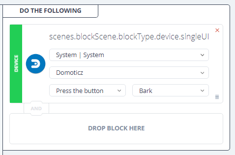

Save your QA and it is now ready to be used in Scenes. Going forward I intend to add more buttons to the QuickApp, allowing only one Device to activate multiple device in Domoticz by using multiple buttons.
In a Scene you can activate the Button as follows:
As said in the beginning, I really hope this helps others, but most of all inspires to further ideas to improve.
