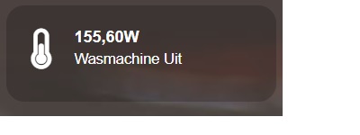

Hi i have a device that show the usage of my wasmachine.
I use id '2103_1' in config.js to show this device
I have the following function to change the ico and the title text, but it does work (anymore)
Can somebody give some help, how to get this working again?
When the wasmachine is in rest, it uses "0.7 Watt" (part two of the IF)
When it is more then 2, it is on... (part 1 of the IF)
2103 is the domoticzID 2103_1 in dashticz

The first line in the function is incorrect:
var usage = block.device.value;
As you can see in the Domoticz device json dump, you see there is no key 'value' in the result part.
Probaby you want to use the field 'Usage'
so change the line to the following:
var usage = block.device.Usage;
Javascript is case sensitive.
All Domoticz device fields, except idx, start with an uppercase character. So 'block.device.usage' will not work.
