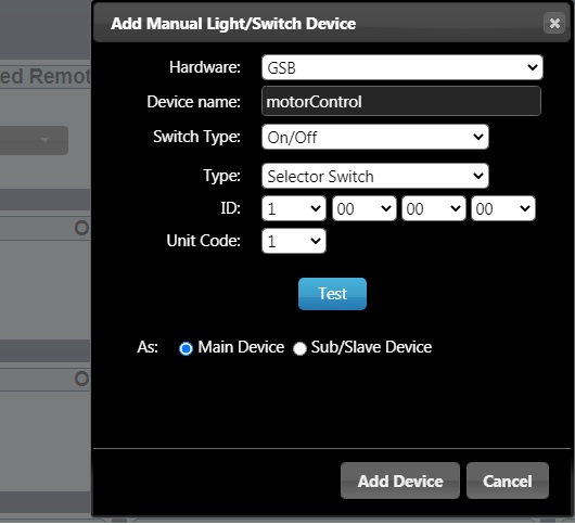

Re: to define a motor as a selector switch...
thanks waaren
i think i understood what u said:
1. manual light/switch
2. type: selector / selector switch
3. id and unit code: i don't know ??
4. add device
5. then the code below:
is that right?
4. add device
