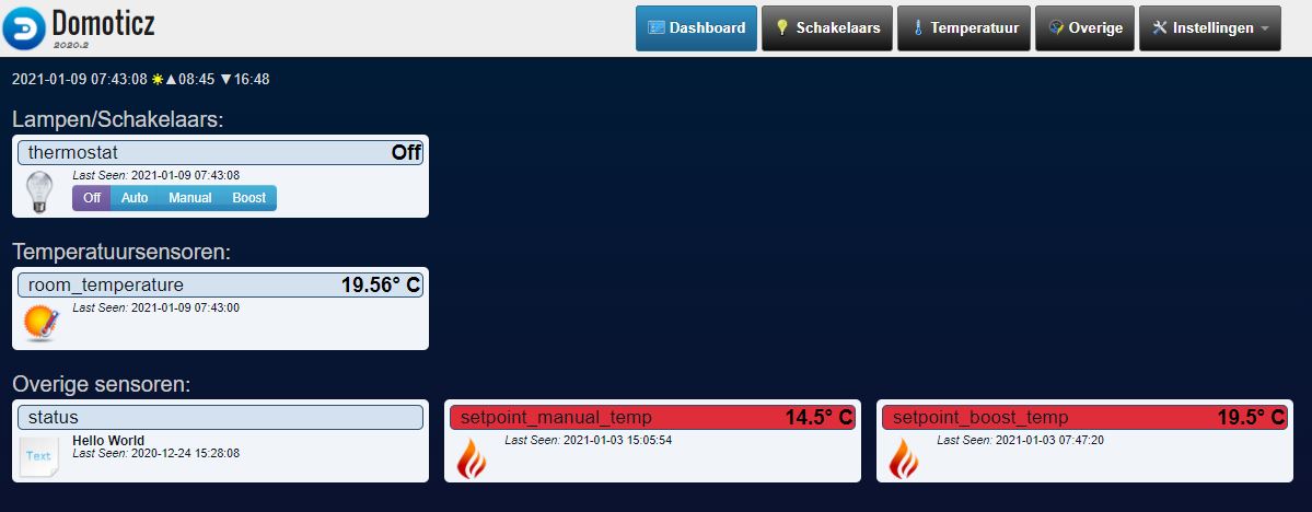

My current number one problem is when the script runs as it is now the state of the switchselector in Domoticz can not be selected.
As if the sript is blocking the state selection.

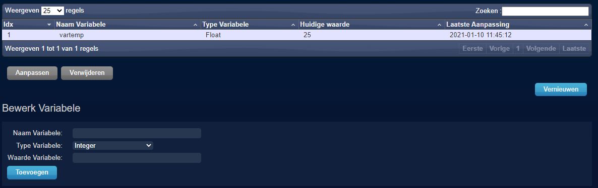

Currently the textbox when auto mode is choosen show a varying table: hex code I assume.
DZ.Debug show the variable as being an integer value like "Set UserVariable vartemp = 25"
Does it matter if vartemp is written sometimes as "vartemp" and sometimes as "varTemp".
WIll this cause different behaviour inside Lua or dzVents?
AS the temperature to be set in the variable needs to be a float ie "21.5" sometimes I declared the variable in domoticz setting as a float but it see it sometimes in the log with an error mentioning it is used with a non correct float or something.
dz-dashboard YAT 1.06-vartemp.JPG (48.3 KiB) Viewed 2238 times
dz-dashboard YAT 1.06.JPG (63.07 KiB) Viewed 2238 times
Re: Yet Another Thermostat script debug
Backbone wrote: Sunday 10 January 2021 11:50 Any guidance would be appreciated.
you should change
tostring(varTemp)
to
varTemp.value
varTemp is the variable object with all attributes and functions stored in a table. You only want the attribute "value"

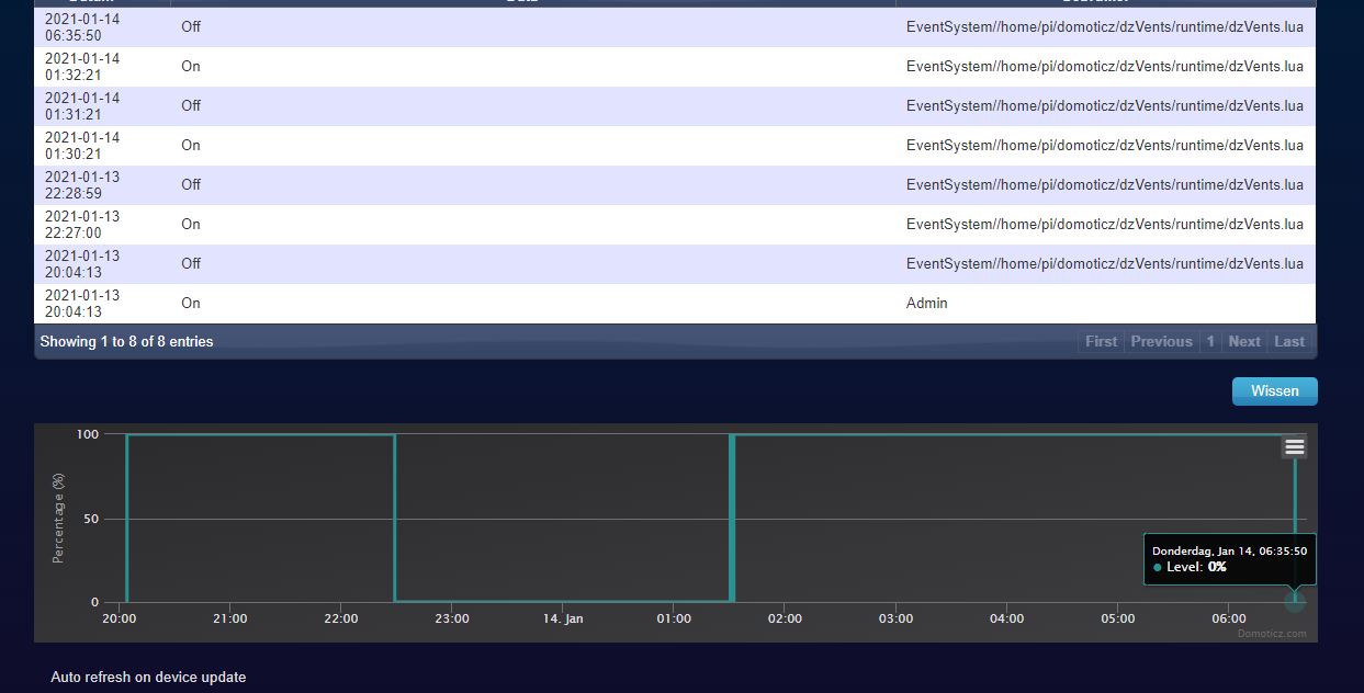

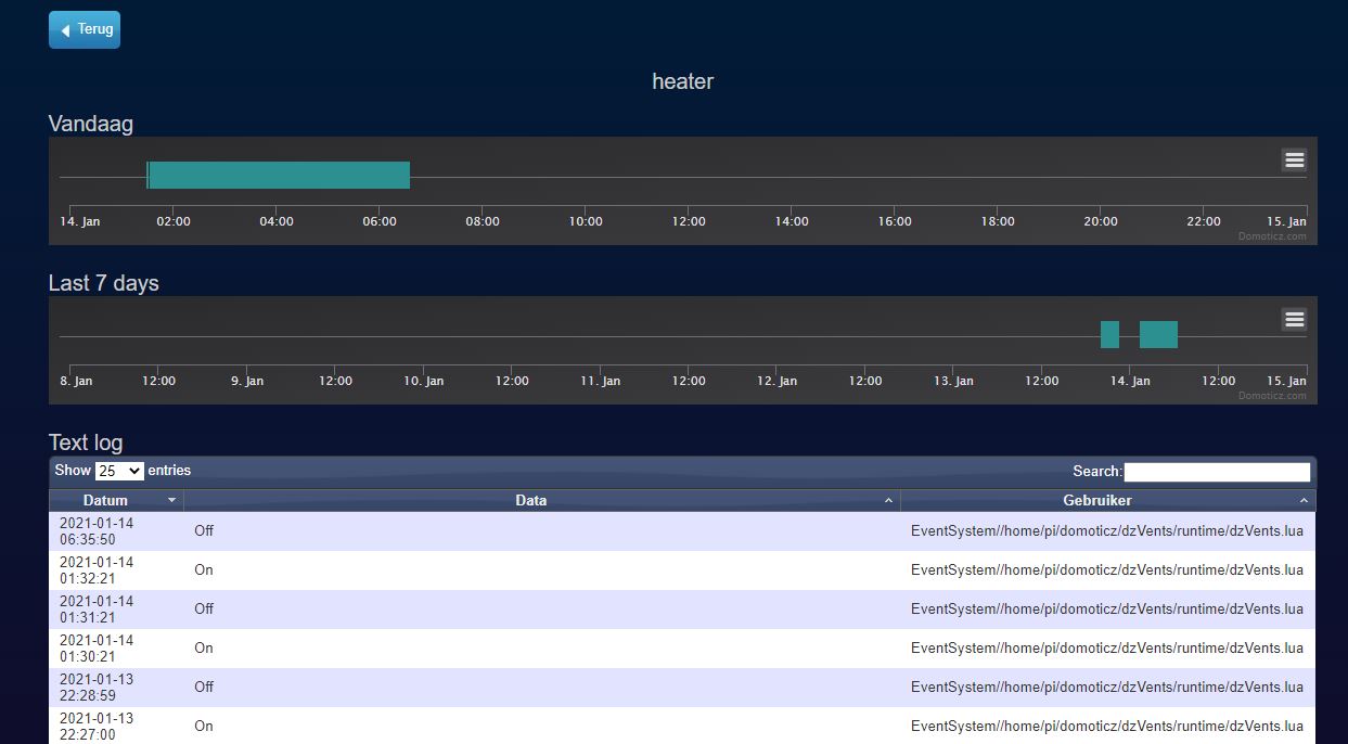

When I check the log status of the "heater" dummy device I can see when the heater is ON or OFF.
But I can only see the blue lines/blocks when I stop the script.
As soon as I start the script and I check again the log of the heater dummy device is gone.
Sometimes the lines and block pop up for a milisecond or so.
They reappear if I stop the script.
Is this correct behaviour of Domoticz in combination with scripts like this?
Is this caused by DZ constantly checking the devices and overloading the routine?
Curious...as always to learn why.
heater action with script off.JPG (89.82 KiB) Viewed 2215 times
heater action with script off2.JPG (91.91 KiB) Viewed 2215 times

Backbone wrote: Thursday 14 January 2021 8:51 But I can only see the blue lines/blocks when I stop the script.
Don't know how this could be related to the script but can you try below? I added the option silent() to the various commands; this will prevent the script from retriggering itself.
Question: Do you really want the script to trigger on any update of ALL named devices in the line
devices = {'thermostat', 'heater', 'room_temperature', 'status', 'setpoint_manual_temp', 'setpoint_boost_temp'},
You only have to include the devices that need to trigger the script when updated.

The heater device is viewable in the log when I do not run Auto mode.
In auto mode the problem still persist.
It is not a major problem as long as the sript switches at the correct trigger points.

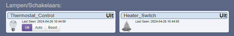

Hello, three years ago my domoticz went down and corrupted.
I am slowly restoring what I have and all works fine and now I am back at debugging the thermostat code.
Difference between 3 years ago and now is even if have code snippets I clearly do not know anymore how far I was in the project that is was working.
So for general sake I stared to take basic snippets to see if the genral logic works and I can progress step by step to where the project crashed/ended.
The below code which is basic for those at a higher level gives opposite result.
Two dummy buttons.
One controls a relay by ESPEASY (Heater_Switch). Works fine if below script is switched OFF.
When I click the icon of the dummy switch the relay goes on and off.
Other switch dummy has three level.
But even with a two levels in the code to just control the relay off on does not work.
I expect:
when I click "Uit" the relay goes OFF and icon of the heater_switch disabled..
when I click "Auto" the relay to swicth ON and the icon of the heater_switch is enabled.
What in basic do I do wrong?

Posts: 6683
Domoticz version: 2025.1
It looks like it should work. Only thing is you also trigger on the Heater_Switch too. So if you set the selector switch it should set the Heater_Switch which will trigger another run of this script (but will not change anything).
Better add some dz.log('here some logging info') statements in each if then so you can see what gets triggered.

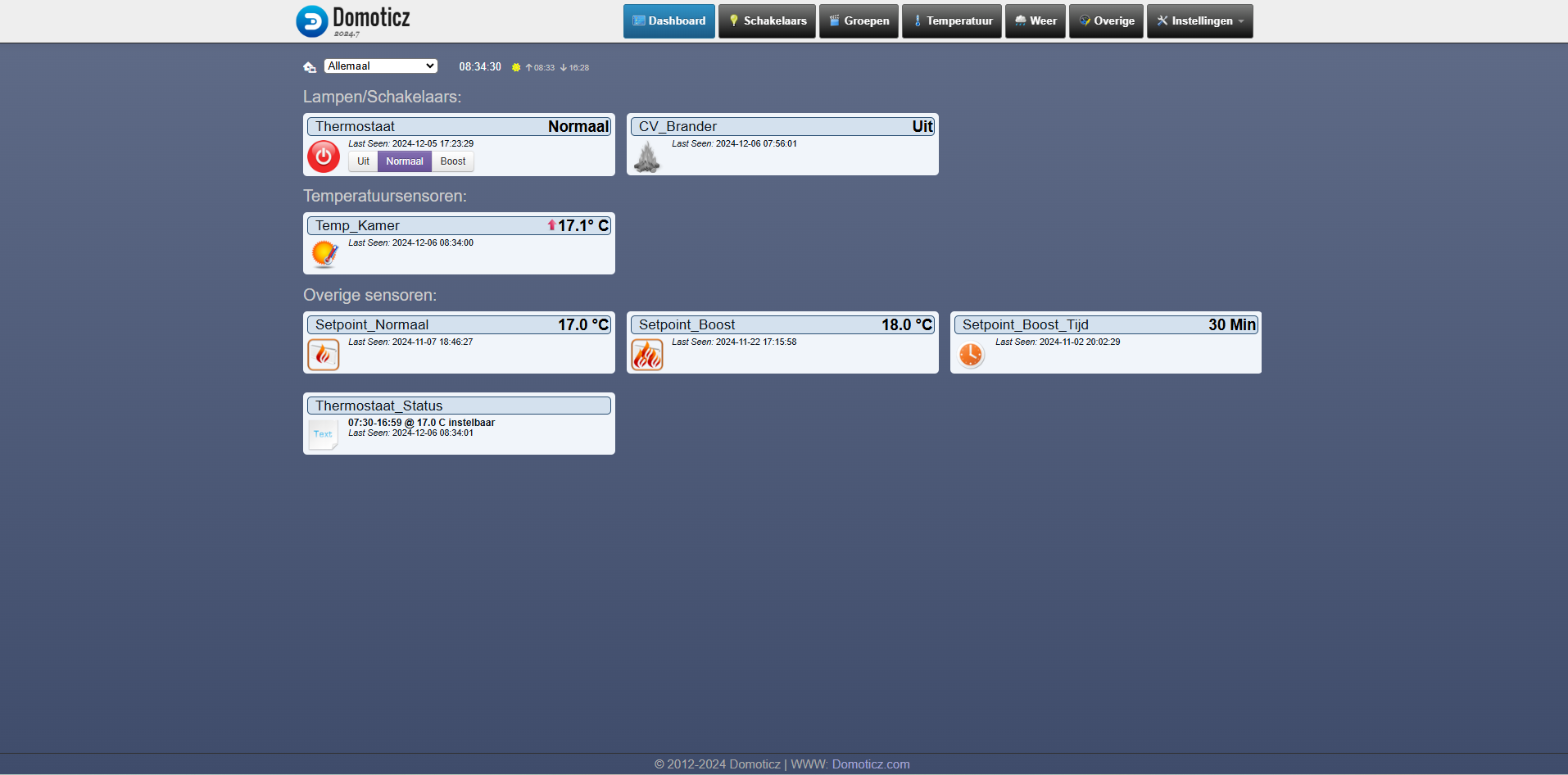

In the meantime I worked more on the code and got what I need and works for my purpose.
Might need polishing but I am happy.
Thanks for all the support who responded with tips and tricks.
It now uses two scripts.
Script1 for the general settings.
As most settings are fixed for daily use, If they need to be changed I just change some lines of code once a year. ;-)
return
        --Thermostaat           -- =idx69   thermostat controller
        --CV_Brander            -- =idx67   cv burner switch
        --Temp_Kamer            -- =idx32   room temperature
        --Setpoint_Normaal      -- =idx68   regular temperature setpoint
        --Setpoint_Boost        -- =idx72   boost temperature setpoint
        --Setpoint_Boost_Tijd   -- =idx75   boost time
        --Thermostaat_Status    -- =idx74   textbox
    on =
        devices = {'Thermostaat', 'CV_Brander', 'Temp_Kamer','Setpoint_Normaal','Setpoint_Boost','Setpoint_Boost_Tijd' },
    execute = function(dz)
        local varTempReg = dz.variables('varTempReg') --declared as float value in settings menu
        varTempReg = dz.devices(68).setPoint
        -- "Uit" mode active, initiated by thermostat switchselector at level 0
        if dz.devices(69).level == 0 then
           dz.devices(67).switchOff().checkFirst()
           dz.devices(74).updateText ('Thermostaat OFF')
           dz.log('Thermostat OFF')
-- mon to thu
        -- "Normaal" mode active, initiated by thermostat switchselector at level 10
        if  dz.time.matchesRule('on mon,tue,wed,thu') then
            if dz.devices(69).level == 10 then
            if  dz.time.matchesRule('at 00:00-05:44') then
                if dz.devices(32).temperature < 16.5 then
                    dz.devices(67).switchOn().checkFirst()
                    dz.devices(74).updateText ('00:00-05:44 @ 16.5 C - preset')
            if  dz.time.matchesRule('at 05:45-06:29') then
                dz.devices(74).updateText ('05:45-06:29 @ 16.5 C- preset')
            if  dz.time.matchesRule('at 06:30-16:59') then
                dz.devices(74).updateText ('06:30-16:59 @ '..varTempReg..' C instelbaar')
                if dz.devices(32).temperature < dz.devices(68).setPoint then
            if  dz.time.matchesRule('at 17:00-19:29') then
                dz.devices(74).updateText ('17:00-19:29 @ 18 C - preset')
                    if dz.devices(32).temperature < 18 then
            if  dz.time.matchesRule('at 19:30-23:59') then
                dz.devices(74).updateText ('19:30-23:59 @ 16.5 C - preset')
end -- mon to thu
--fri to sun
    if dz.time.matchesRule('on fri,sat,sun') then
            if  dz.time.matchesRule('at 00:00-07:29') then
                    dz.devices(74).updateText ('00:00-07:29 @ 16.5 C - preset')
            if  dz.time.matchesRule('at 07:30-16:59') then
                dz.devices(74).updateText ('07:30-16:59 @ '..varTempReg..' C instelbaar')
                dz.devices(74).updateText ('17:00-19:29 @ '..varTempReg..' C instelbaar')
    end --fri to sun
script 2 for the boost override and timer
    on =
        devices = {'Thermostaat' } ,variables = {'vartemp'}, variables = {'varTime'}
        local varTemp = dz.variables('varTemp')    --declared as value in settings menu
        local varTime = dz.variables('varTime')    --declared as value in settings menu
        varTemp = dz.devices(72).setPoint
        varTime = dz.devices(75).setPoint
        -- "Boost" mode active, initiated by thermostat switchselector at level 20
            if dz.devices(69).level == 20 then
                dz.devices(74).updateText ('Thermostaat Boost @ '..varTemp..' C @ '..varTime.. ' minutes')
                if dz.devices(32).temperature < dz.devices(72).setPoint then
                    dz.devices(67).switchOff().checkFirst().afterMin(varTime)
                    dz.devices(69).switchSelector(10).afterMin(varTime) --switch back to "Normaal" mode after set time
                    --dz.devices(67).switchOn().checkFirst()
                    --dz.devices(67).switchOff().checkFirst()
                    dz.devices(74).updateText ('Thermostaat @ Setpoint_Regular')
Schermafbeelding 2024-12-06 084033.png (47.25 KiB) Viewed 1075 times
Schermafbeelding 2024-12-06 083450.png (137.67 KiB) Viewed 1075 times
