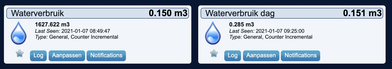

For what I understand from the dzVents documentation the updateCounter statement should overwrite the value of the counter. But nothing seems to happen. So as an experiment I changed the updateCounter(0) with updateCounter(1) and to my surprise the counter got incremented.
Schermafbeelding 2021-01-07 om 09.44.41.png (77.37 KiB) Viewed 1881 times
What I want is the 0.285 value in the image above to reset to zero at midnight. I want to use this value in Dashticz to present today's water usage.
Can anybody help?

The updateCounter method does not overwrite the value of an incremental counter but increments just like the incrementCounter method.
The wiki is not clear on this and will be updated.
