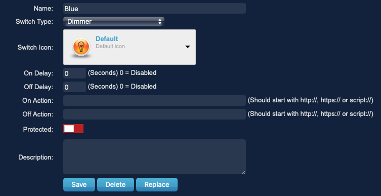

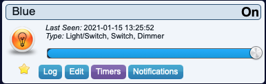

I managed to achieve dimming powerleds lamp using domoticz + python + pca9685 (PWM dimming) with "dummy virtual switch" (name = Blue).
Screenshot 2021-01-15 at 14.55.54.png (24.43 KiB) Viewed 355 times
Screenshot 2021-01-15 at 14.56.13.png (50.31 KiB) Viewed 355 times
Python script (/home/domoticz/akwarium/led-dimming.py ):
