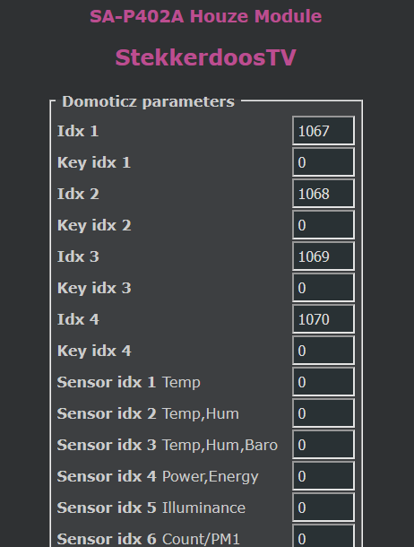

I'm using the Houzetek 4AC 3USB Power Strip, flashed with Tasmota 9.1.0.
Everytink works fine exception relay 5, i can't configure it in the domoticz tab, i can only configure 4 relays.
I've tried to make a rule, but this one is not working.
Rule1 ON command#idx =1066 DO POWER5 toggle ENDON
Has someone an sollution for this?
Greeting Piacco
