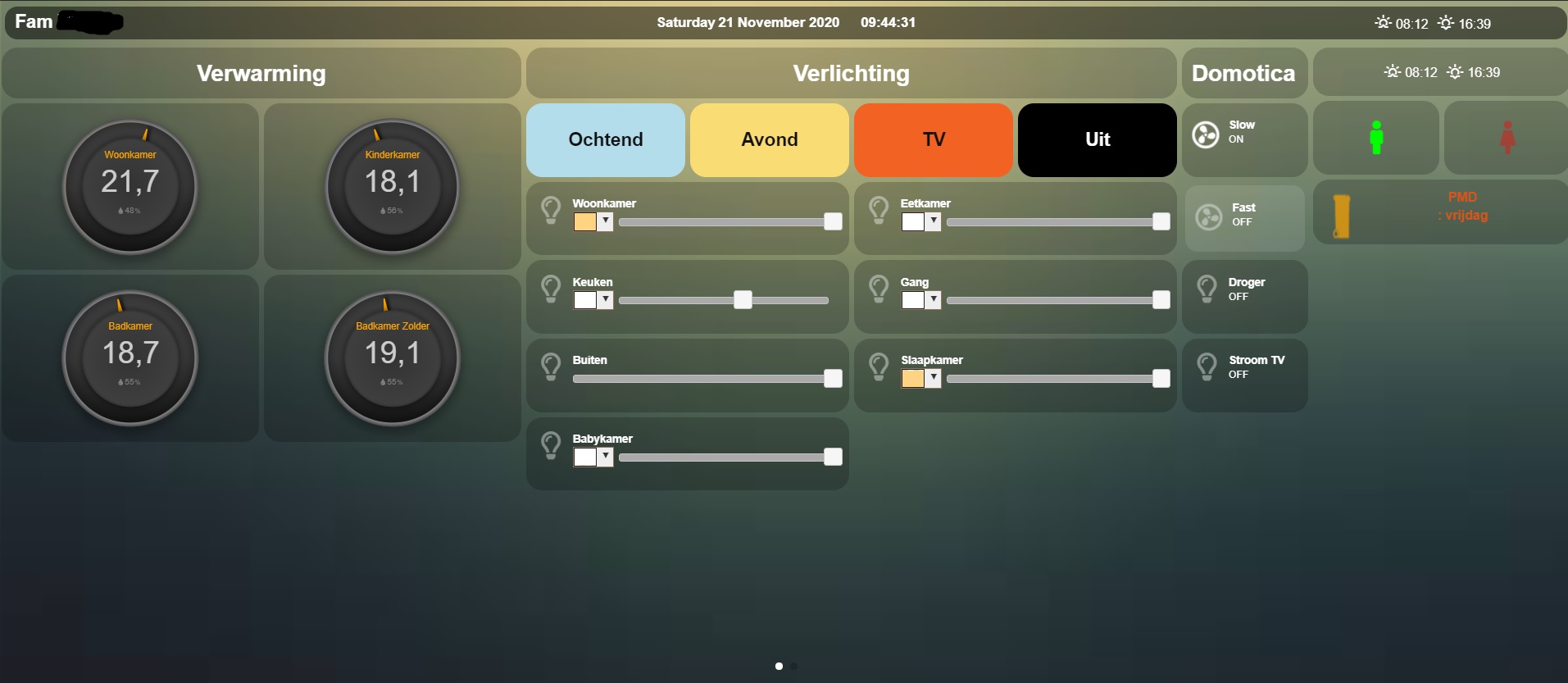

hey guys,
just wondering, is anyone able to change the background color of a block to the color of the light?
so if the light are on and red the background should be red and if the lights are off the standard background color.
I posted the following question in another post but maybe I get a reaction in this post:
the garbage app is working great, I put a line break between the type of container and the date/day which makes the colon obsolete. Is there any way to remove the colon?
thanx in advance,
Jacco
