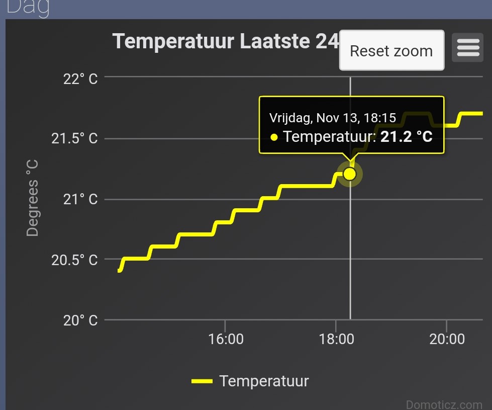

I use an fibaro motion sensor for measuring temperature, if temp comes below setpoint my heating starts for a while of 15 minutes.
Looks like it the sensor gives it value each 5 minutes or each 0,1 difference in degrees.
How could I change config this way the sensor would report each 30 minutes in example? I will try to attach some screenshots, thanks in advance,
Ger

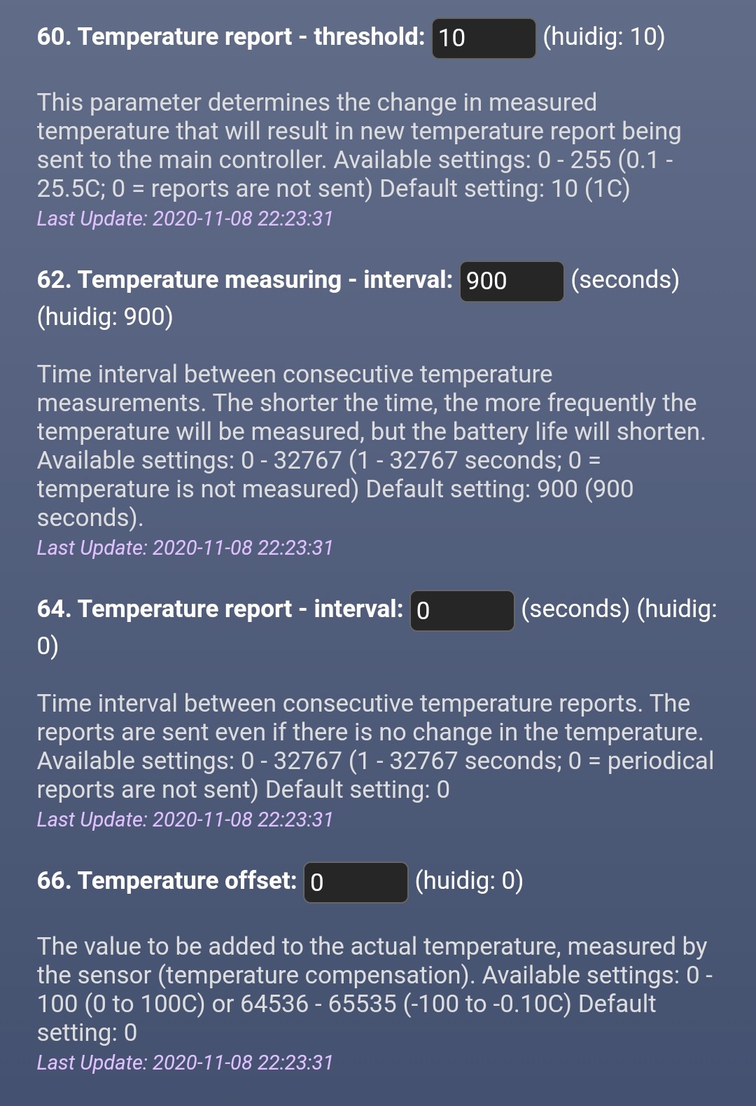

jake
Posts: 753
Re: Fibaro motion sensor, report temperature interval
Post by jake »
Go to the hardware page, open the zwave hardware, click on the sensor and adapt the sensor parameters to your wishes
