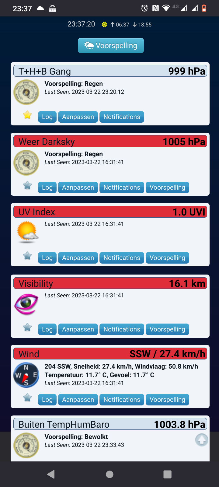

What/how do you mean?pipiche wrote:it is dead today !
Screenshot? Error messages?
- Posts: 7020
- Domoticz version: 2026.3
Re: Darksky still in forecast after switch OpenWeather.
Darksky seems to be not working from 16:31 today
Also a 502 bad gateway error is shown.
