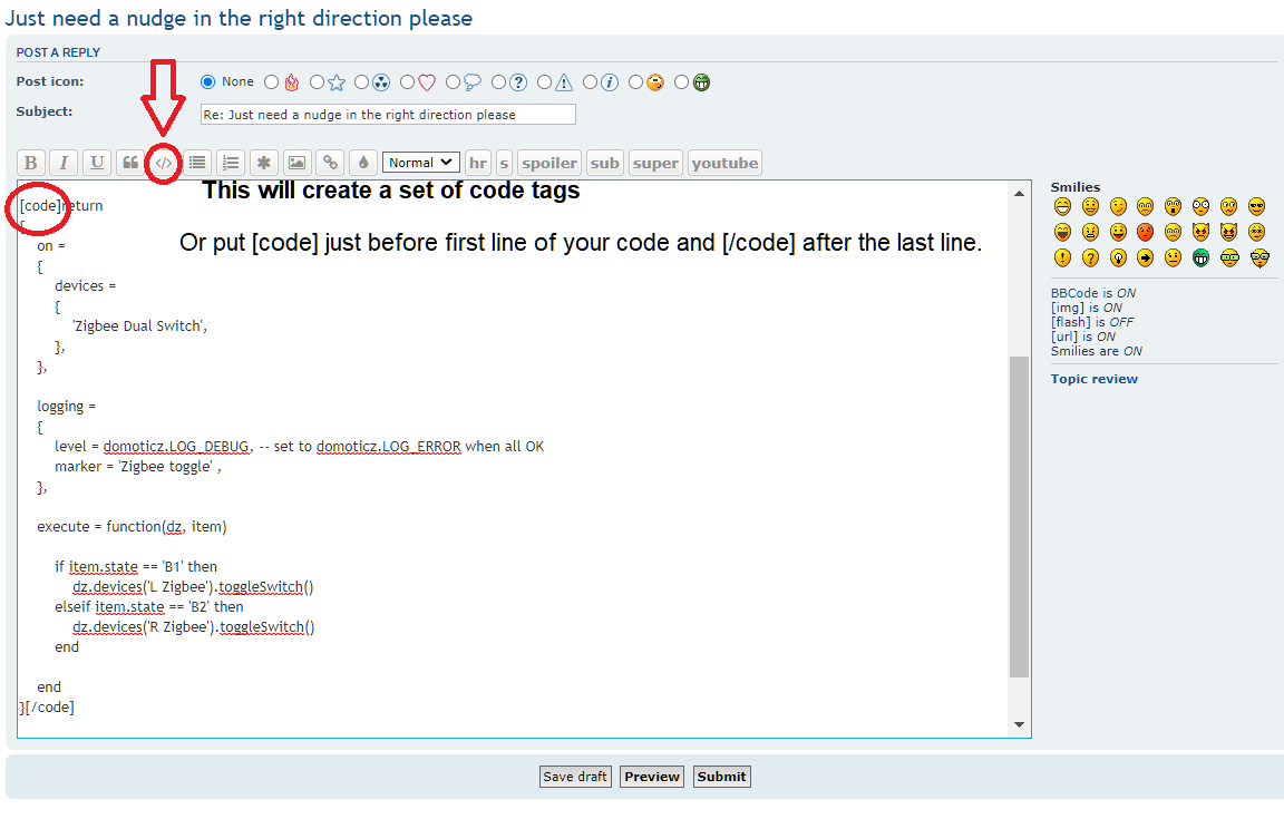

Thanks for your reply waaren, I now have the error log below, please don't think I'm being rude but what do you mean by "between code tags"

Corrected by adding quotes around the marker string. This should do it
return
    on =
        devices =
            'Zigbee Dual Switch',
    logging =
        level = domoticz.LOG_DEBUG, -- set to domoticz.LOG_ERROR when all OK
        marker = 'Zigbee toggle' ,
    execute = function(dz, item)
        if item.state == 'B1' then
            dz.devices('L Zigbee').toggleSwitch()
        elseif item.state == 'B2' then
            dz.devices('R Zigbee').toggleSwitch()
Re: Just need a nudge in the right direction please
