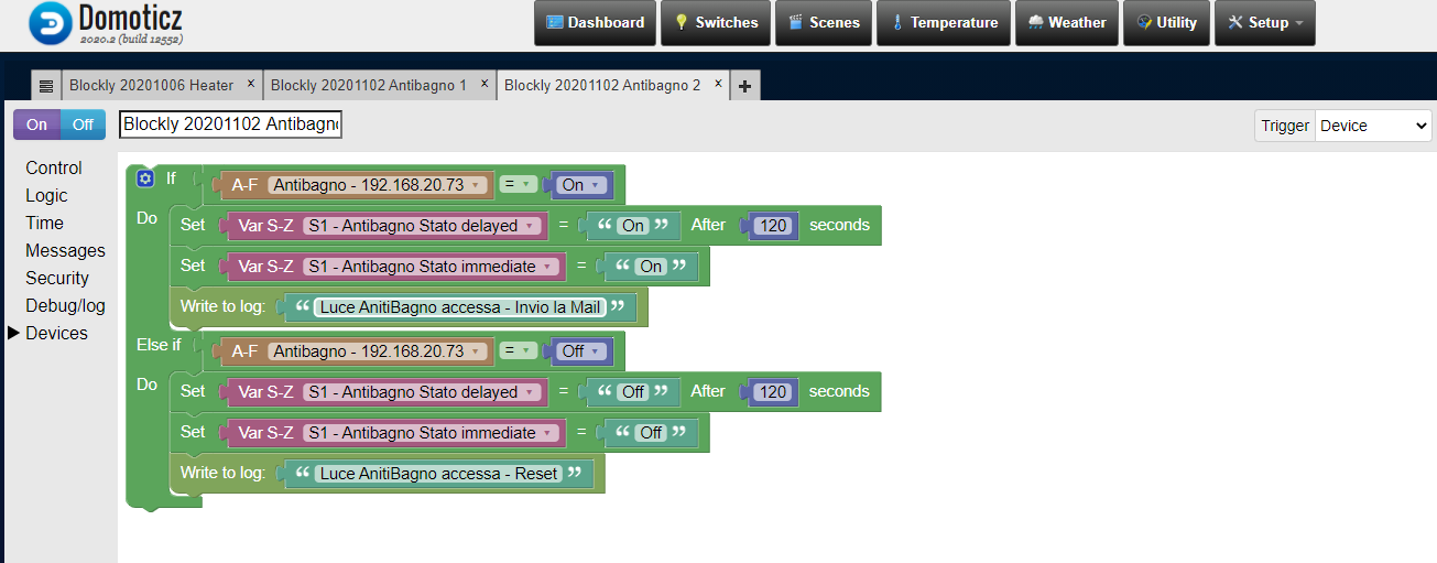

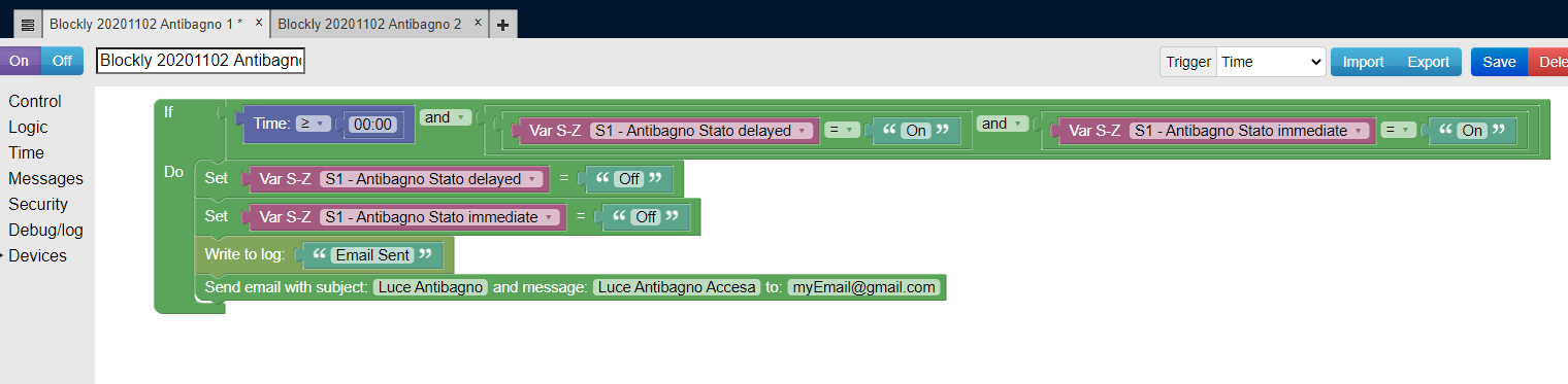

If you want to this in Blockly you probably need an extra variable and two Blockly's
One triggered by the device and another one triggered on time.
device triggered Blockly
Antibagno 1.png (102.95 KiB) Viewed 514 times
Time triggered Blockly
Antibagno 2.png (60.34 KiB) Viewed 514 times

Hi waaren, thank you very much for your support, but i have another question ;)
how should i define the two variables?
Variabile Name= S1 - Antibagno Stato delayed
Variabile Type= ??
Variable Value=??
Re: If the switch is on for more than two minutes --> Send message
foscolino wrote: Tuesday 03 November 2020 14:07 how should i define the two variables?
Type: string
value: Off
