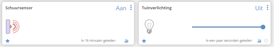

What Domoticz theme are you using, this looks pretty nice Widget ?

pipiche wrote: Sunday 25 October 2020 19:04 Ok, so I suggest that your remove the Widget On/Off , then you redo the pairing, it should create Plug, Power and Meter (at least)
Nice! i Got:
- light switch
- watt usage
- volt
- kWh
Raspberry Pi 4 - Raspbian bullseye - Python 3.9 - stable
Dashticz on apache2 - Mqqt - node red
Zigate - USB Tll - Philips hue - Ikea - Innr - Xiaomi - TPlink - Nest -v3
RezaRose
Posts: 65
Joined: Sunday 09 February 2020 11:34
Location: Holland
Re: Zigate errors: onMessage' failed 'error':'argument out of range'.
Post by RezaRose »
pipiche wrote: Sunday 25 October 2020 19:16 Don't take too much attention to the Startup report. It is not necessary reporting all devices connected to ZiGate.
Machinon, it is a very nice theme.
