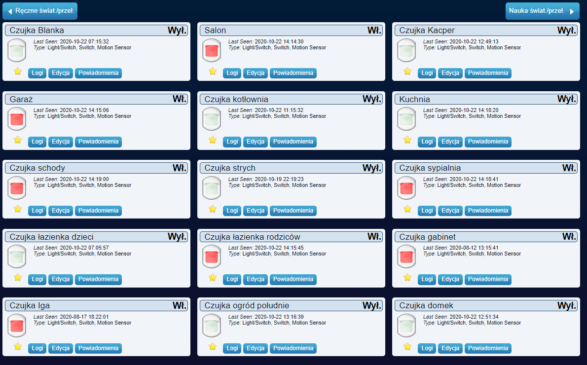

Sorry my fault I have also the temp+hum sensors behind the motion sensors - I disabled them to not confused log output.
Motion sensors are Light/Switch type (wireless 433MHz) with Sonoff RF Bridge.

2020-10-22 14:14:51.431 MQTT: Topic: domoticz/in, Message: {"idx":10,"nvalue":0,"svalue":"15599950","Battery":59,"RSSI":6}
2020-10-22 14:14:51.556 MQTT: Topic: domoticz/in, Message: {"idx":59,"nvalue":0,"svalue":"15599950","Battery":57,"RSSI":9}
2020-10-22 14:14:57.082 MQTT: Topic: domoticz/in, Message: {"idx":59,"nvalue":0,"svalue":"15634430","Battery":57,"RSSI":9}
2020-10-22 14:14:57.205 MQTT: Topic: domoticz/in, Message: {"idx":10,"nvalue":0,"svalue":"15634430","Battery":59,"RSSI":7}
2020-10-22 14:15:04.637 MQTT: Topic: domoticz/in, Message: {"idx":10,"nvalue":0,"svalue":"14761994","Battery":59,"RSSI":5}
2020-10-22 14:15:04.961 Status: EventSystem: Script event triggered: /home/pi/domoticz/dzVents/runtime/dzVents.lua
2020-10-22 14:15:05.012 (Dummy) Light/Switch (Drzwi garaż)
2020-10-22 14:15:06.238 MQTT: Topic: domoticz/in, Message: {"idx":59,"nvalue":0,"svalue":"15506830","Battery":57,"RSSI":9}
2020-10-22 14:15:06.581 (Dummy) Light/Switch (Garaż)
2020-10-22 14:15:06.560 Status: EventSystem: Script event triggered: /home/pi/domoticz/dzVents/runtime/dzVents.lua
2020-10-22 14:15:07.131 MQTT: Topic: domoticz/in, Message: {"idx":10,"nvalue":0,"svalue":"15506830","Battery":59,"RSSI":5}
2020-10-22 14:15:11.861 MQTT: Topic: domoticz/in, Message: {"idx":59,"nvalue":0,"svalue":"14761994","Battery":57,"RSSI":9}
2020-10-22 14:15:12.221 (Dummy) Light/Switch (Drzwi garaż)
2020-10-22 14:15:12.508 MQTT: Topic: domoticz/in, Message: {"idx":1
2020-10-22 14_19_03-Domoticz.png (95.75 KiB) Viewed 1135 times
